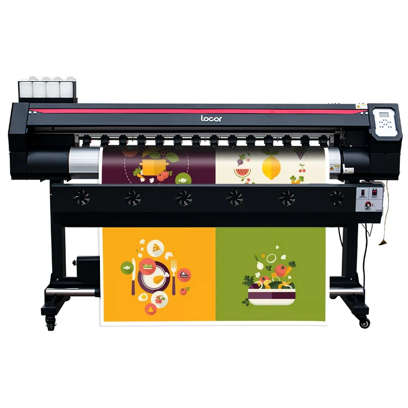

slice&dice 2,469 Posted July 25, 2020 Smitay, you are all over the place. Stop, take a deep breath, and focus on what you are being told. There are many threads in this Forum regarding first-time purchases. In fact, there is an entire discussion section devoted to just that topic. You presented a graphic that will make you absolutely crazy trying to do it in cut vinyl (especially at a small size). THIS is the type of printer that the industry is moving towards, and they are expensive and have a whole range of other considerations of ownership. 1 Share this post Link to post Share on other sites
haumana 1,228 Posted July 25, 2020 the design you posted ... I would just hit up sticker mule for that. I don't have enough business to justify a wide format color solvent printer, cold laminator, and wide format cutter. That kind of stuff gets immediately outsourced to places like sticker mule. to get a solvent printer/cutter will be way, way, way out of your budget. you might want to check into how much some of the materials that you're wanting to buy will be, because some of them will not be cheap. $900 for an entire setup: cutter, heat press, vinyl, squeegee, pick, app tape, etc. It will all add up. 1 Share this post Link to post Share on other sites

Dakotagrafx 7,298 Posted July 25, 2020 personally I cut vinyl products for when that product is appropriate - both decals and apparel, if large enough apparel order I order plastisol transfers which reduce cost on most orders where the same image is used 30+ times (wildgoose is our apparel expert) for decals I have owned 3 solvent printers and you need enough business to keep that very expensive unit busy every couple of days or the maint will eat you alive if you don't clog heads - the printers I had were $700 per head (my first one had 4 heads and last 2 only had 2 heads) but I found as my wife and I travel more and the printer sat for 3 week vacations I could plan on replacing at least one head a trip. solvent printers are sexy but there are so many people doing them now the profit has deteriorated. you can get away from the solvent with a latex printer which doesn't clog heads but requires a special 220 dedicated line and cost more to print. I am unfamiliar how the latex does with apparel. banners you can outsource much cheaper than you can make them inhouse. I quit trying to compete with products so many people already produce and the few printed decals I still offer are done by stickermule like Haumana. trade shows area a great way to learn but are hard to come by until the virus subsides - maybe start with a good plotter to do cut decals and move into a decent heat press for small one off apparel - which you will have to charge much more than the screen printers can do them for. get your tax license so you can order from sanmar for your shirts. - you won't be sorry. Do you have any experience working with vector graphics will be another learning curve as it is quite different than pixel based photos you are used to manipulating - either download signblazer or inkscape just to see what you are getting into and when you order you plotter I suggest the vinylmaster option - it is powerful, the base software that comes with the plotter can be upgraded (there is a discount code for 50 percent off upgrades in the vinylmaster section). Get your plotter and start learning - each one is different - I am a hard core graphtec user and have had almost no issues since I worked up to my first one 8+ years ago but the one I got this week and a quirk I need to contact graphtec support about either monday or after I return from a short trip next week. this is a brand new model and probably one of the first ones produced - - - there will be a learning curve involved in your new venture - 3 Share this post Link to post Share on other sites
