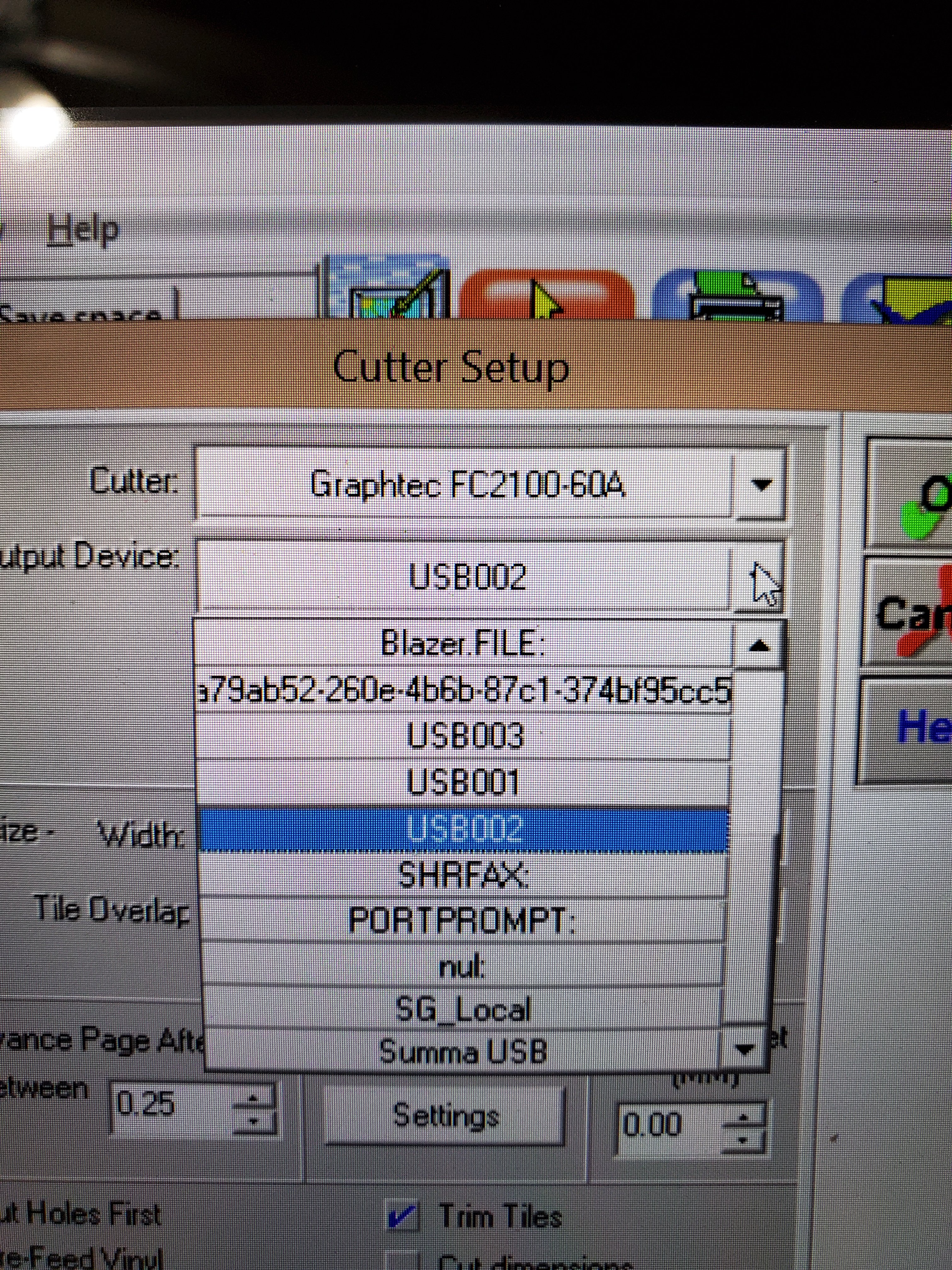

odokie 8 Posted December 19, 2022 So I have installed both drivers mentioned above and the USB options are not showing up. I am using USB002 on my current computer but isn't an option on the new one. Is it the drivers that adds this? I'm using windows 11 and its way different than my windows 8 the first attachment is what I use on my old computer that cuts perfect! the second attachment is what my new computer looks like in the "Output device" Sorry I'm not tec savvy at all! Thanks! Mary Ann Share this post Link to post Share on other sites
darcshadow 1,626 Posted December 19, 2022 You have 3 USB ports showing on the first screen, plug your cutter into one and select it. The Blazer thing you're looking at Blazer.COM1, on the other computer a serial port. Share this post Link to post Share on other sites
odokie 8 Posted December 19, 2022 Thanks for your help! The first screen shot is on the computer that does work. the second screen shot are the options on the new computer that im trying to get the program set up on. don't know what to do to get the 3 USB options on it. Share this post Link to post Share on other sites
darcshadow 1,626 Posted December 19, 2022 ah! sorry. I think you have a problem with SB then, not your driver. SB should show your USB ports no matter what device drivers you have. Does the new laptop have "normal" usb ports? Several new computer only have USB-C, or USB-3. USB3 connectors look like traditional USB ports but are blue inside, or have and SS near them. SB might be old enough that it doesn't recognize USB3, I've not tried it on a newer machine. There are several on here that still use SB, maybe one of them can chime in if it works with USB3 ports or not. Might try uninstalling and reinstalling SB. In the mean time, what you could do, install the graphtec software and use it to cut with. You can still do your design and layout in SB, then just export it as an EPS file and open that into the graphtec software. I have not used said software, but from what I understand you should find it's much more capable than SB and works quite well. Share this post Link to post Share on other sites
MZ SKEETER 4,708 Posted December 19, 2022 I have the same version of Signblazer 6.0 installed on a Windows 7 laptop and Windows 10. USB output on set up is only showing up in the software on Windows 7. Not on Windows 10. Share this post Link to post Share on other sites

slice&dice 2,450 Posted December 20, 2022 odokie, if you want to delve into the Device Manager on your Win10 system, that would be the place to mess around and set your USB port manually, using the "Advanced" tab in the Properties dialogue. A few years ago, I had a problem with a laptop computer recognizing USB connection and was able to resolve that issue by installing a Virtual Com Port, using STM32 VCP http://kiss.flyduino.net/download/stm32-virtual-com-drivers-64bit-pc (ST microelectronics software for quadcopter flight controllers). I realize that's a 'workaround' method, but if it works, it works. Share this post Link to post Share on other sites
MZ SKEETER 4,708 Posted December 20, 2022 The Windows 10 computer, could be used with a Tripp-lite Keyspan Adapter, with a null modem cable to your cutter. It must be null modem. I think that is 25 pin RS232C. That is what my Graphtecs are. The USB end of Tripp-lite goes into your USB on computer, Then the null modem cable connects to the Tripp-lite Keyspan Adapter, then to your vinyl cutter. The Tripp-lite has it's own driver to install and shows up in the cutter set up. Tripp-lite Keyspan Adapter is the brand name, and only one that is guaranteed to work with a vinyl cutter. It has to be between com # 1-4 Example below. Find the best price. https://www.amazon.com/Tripp-Lite-Keyspan-High-Speed-USA-19HS/dp/B0000VYJRY/ref=sr_1_3?crid=6KD3FRJNEHKZ&keywords=tripp-lite+usa-19hs+keyspan+high-speed+usb+to+serial+adapter&qid=1671554709&sprefix=Tripp+lite+Keyspan+adapter%2Caps%2C159&sr=8-3 Share this post Link to post Share on other sites
