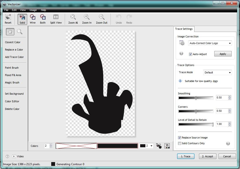

CajunCustom 29 Posted October 31, 2014 Can anyone answer this question ive came across this a couple times , i have a image when i go to cut it , it needs vectored when i vectorze it , it kinda flips and i havent figured out how to revert the image , i can take the same file upload it to a vertorize site online and it vectors fine Share this post Link to post Share on other sites
security802 686 Posted October 31, 2014 To me it looks like 1 should be fill color ie black and 2 should have the x symbol for no fill.... Just how I see it mot 100% cause I do not use that program. Worth a try and good luck Share this post Link to post Share on other sites
CajunCustom 29 Posted November 1, 2014 i think you are right in the areas i click the white then the image turns to normal but when i click vector then its white like above instead of black Share this post Link to post Share on other sites
