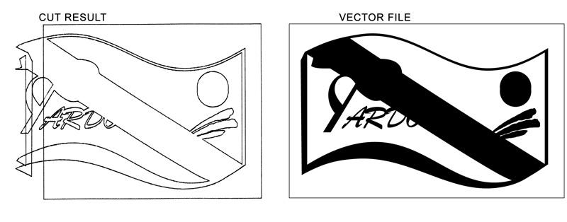

Xpanic 0 Posted July 23, 2013 Hi all, new in the forum. I have the following issue: When cutting a contour with the laserpoint the cutter fails producing also like a "mirror cut" on the right side of the plotter. You can find a attached image that better explains the problem. Thank you in advance Share this post Link to post Share on other sites

jaybyrd 3,770 Posted July 23, 2013 Are you just trying to cut around the outside? If so why all the cut lines through the design area. Share this post Link to post Share on other sites
Xpanic 0 Posted July 23, 2013 The file is a simple illustrator vector, if cutted in "normal mode" all works fine. The problems exists only using the countour cut function (simple/advanced) in signcut. Share this post Link to post Share on other sites

Xpanic 0 Posted July 23, 2013 @Mz Skeeter: I really have a MH721 with laserpoint. Problem FIXED: I've putted the laser a little bit "far" from the first registration mark, at about 1cm, instead of just near. Share this post Link to post Share on other sites
