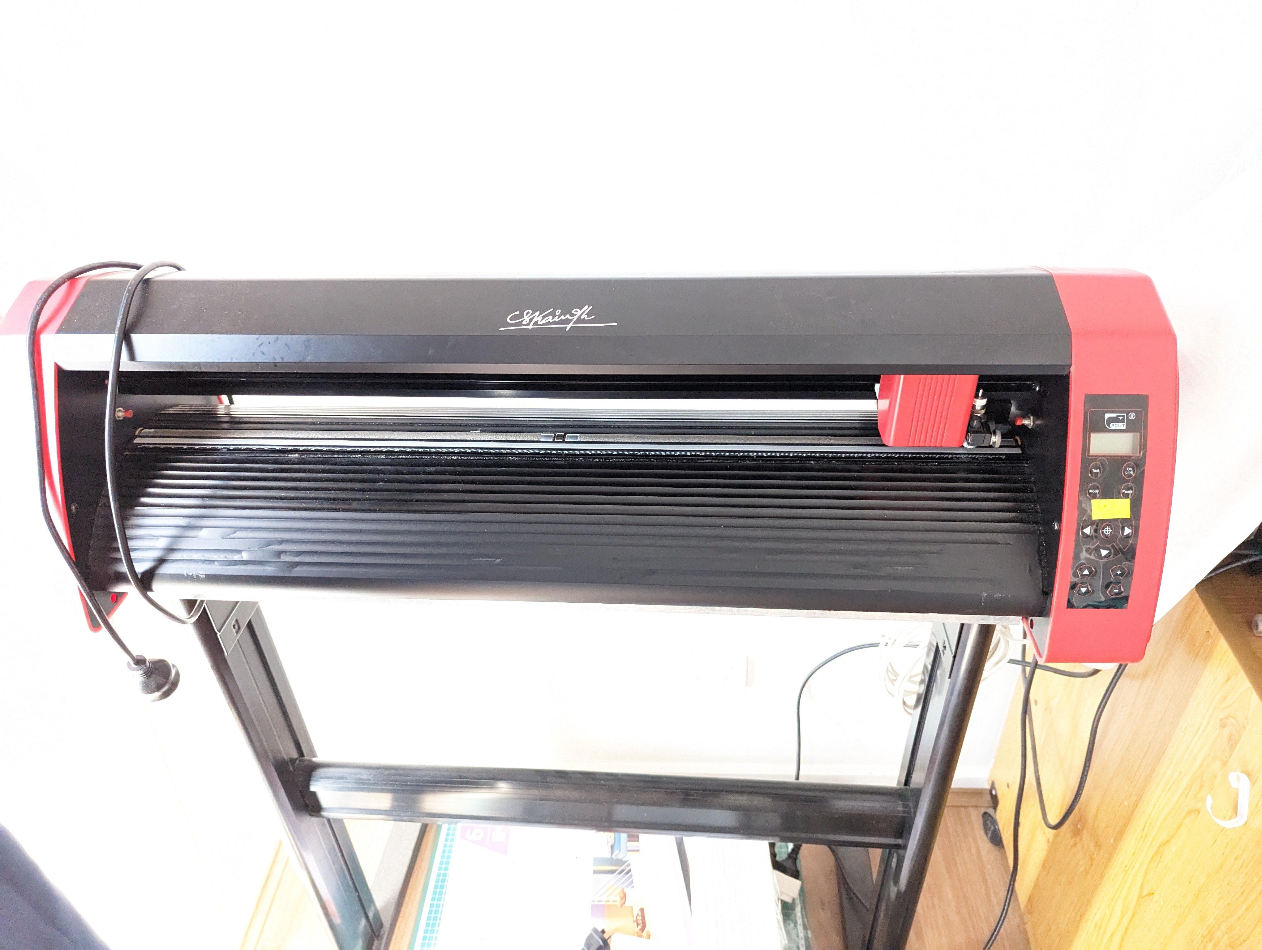

kainth.c.s 56 Posted February 8, 2023 Just bought trying to hook it up. But don’t know what Model it is . Also if anyone has it are you using Flexi??? or did I just buy a paper weight thank you! It's Creation PCUT CT1200 and will work well on Flexi. I have a PCUT CT630 Share this post Link to post Share on other sites
haumana 1,228 Posted February 8, 2023 That's a 1st gen LaserPoint, I used the one of the Creation Pcut software 'driver' when I ran it on my older Win7 box, don't recall the specific one, but Kainth is probably right - I probably used the CT630 driver. I haven't dusted it off in a while. Share this post Link to post Share on other sites
kainth.c.s 56 Posted February 12, 2023 It's Creation PCUT CT1200 and will work well on Flexi. I have a PCUT CT630 See this is what I have. The control panel is the same as yours one. So I confidently beliwve its Creation Pcut CT series or CTO series. Share this post Link to post Share on other sites
