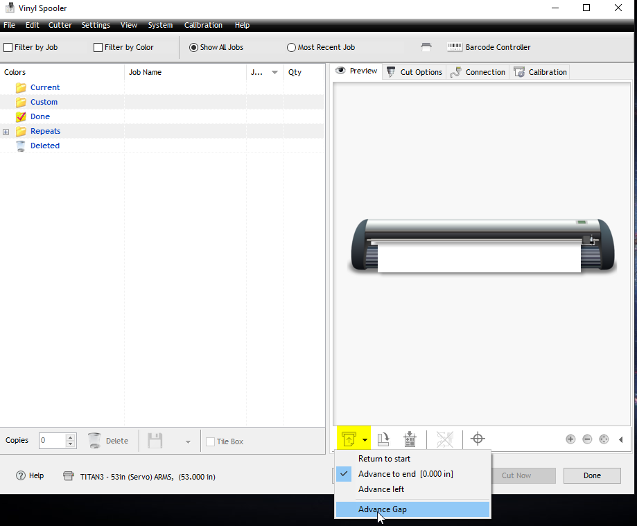

KennethS 0 Posted June 10, 2021 I know it has almost been a year since the last post...but I think I found the answer. Open the vinyl spooler, and click the "Advance Method" drop down (highlighted in yellow), and then choose "Advance Gap", and set it to the desired length. n Share this post Link to post Share on other sites
haumana 1,228 Posted June 10, 2021 8 hours ago, KennethS said: I know it has almost been a year since the last post...but I think I found the answer. Open the vinyl spooler, and click the "Advance Method" drop down (highlighted in yellow), and then choose "Advance Gap", and set it to the desired length. Regardless of the age of the post, helpful contributions are always appreciated. Thank you for taking the time to post your suggestion. Share this post Link to post Share on other sites
darcshadow 1,641 Posted June 11, 2021 Agree, this is a great find, although, what version of software do you have? I just looked in mine and the Advance Gap is not an option for me. Share this post Link to post Share on other sites
