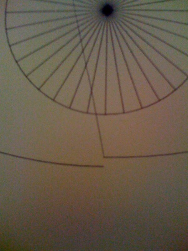

paranoid56 0 Posted August 5, 2009 well tried all the stuff mentioned and nothing seems to help. even the people at uscutter are unsure LOL here are some more pics. also to note, when doing the self test when cutting the huge circle the paper started to bunch up as seen in the pic. http://lh4.ggpht.com/_wdu0CNqB-8E/Snn1IAkuLiI/AAAAAAAAOdY/RzaL2dUDcm4/s800/pcut2.jpg[/img] http://lh3.ggpht.com/_wdu0CNqB-8E/Snn1IhRnsyI/AAAAAAAAOdg/y8Dc6O4is0M/s800/pcut3.jpg[/img] Share this post Link to post Share on other sites
cutme 5 Posted August 6, 2009 a third pinch roller in teh middle would help control the buckling. also try easing up on the pressure a little. bb Share this post Link to post Share on other sites

paranoid56 0 Posted August 10, 2009 so i checked the tighness of the belts and head and all are tight. i fixed the bunching of paper and when i do the test now it looks fine. could a cut up cutting strip cause these type of issues? Share this post Link to post Share on other sites
