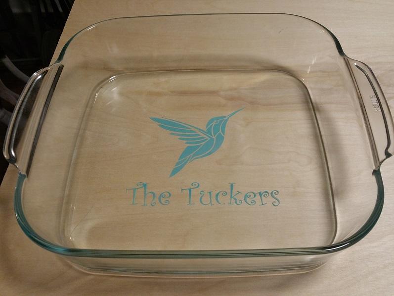

So I decided to make a quick Mother's Day gift since I'm going to see my parents for the weekend.
One of the hardest things was finding glass with no maker's marks on the clear bottom.
I used a mirror image vinyl stencil on the bottom of the dish then etched it with an air eraser then used rub n' buff to color the etch
The dish is actually pretty big, the etching itself is a little over 6" x 6"

It does look great!  How about a follow up to let us know what happens after a couple trips through the oven & dishwasher?
Cal
Share this post
Link to post
Share on other sites
I put some gold colored rub-n-buff on one of my wife's aluminum cookie sheets and it has survived pretty good. On glass I would like to hear some results too.
