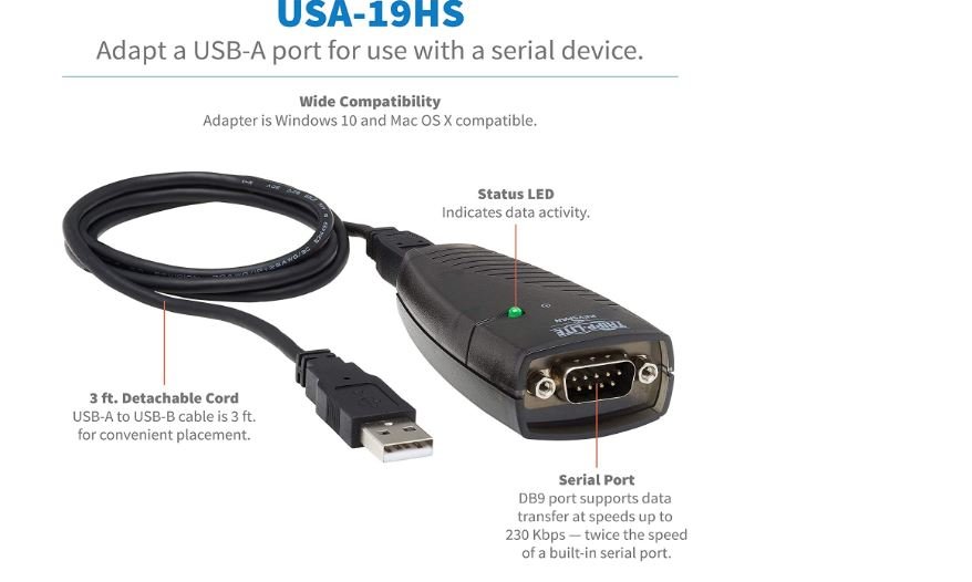

MZ SKEETER 4,727 Posted December 9, 2021 This is what you should have ordered. It required you to download and install the driver. You will plug the USB end into your computer USB. Then connect your null modem cable, that came with your cutter, to the other end to the Tripplite then the other end to your vinyl cutter. You have to find the Com port number in your device manager of your computer. Reboot your computer. after installing. Then select the same com port number in your cutting software set up.. Can only be 1-4 com port number. Share this post Link to post Share on other sites
CMJ 1 Posted December 9, 2021 This is what I ordered but it says plug and play Share this post Link to post Share on other sites
MZ SKEETER 4,727 Posted December 9, 2021 I see they have some kind of a Keyspan assistant to it now. So did you find the com port that it installed to? Read the user manual for it. You must find the correct com port number, then go into your cutting software set up and choose the same com port number. They must match. Share this post Link to post Share on other sites
CMJ 1 Posted December 9, 2021 6 minutes ago, MZ SKEETER said: I see they have some kind of a Keyspan assistant to it now. So did you find the com port that it installed to? Read the user manual for it. You must find the correct com port number, then go into your cutting software set up and choose the same com port number. They must match. I will go do that now. Share this post Link to post Share on other sites
