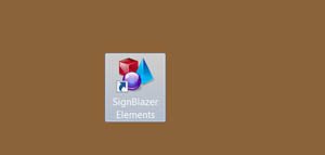

slice&dice 2,469 Posted March 7, 2021 You're welcome. Just a side note: This designated v7.0.0 has a different avatar (icon) after install on the desktop. The old program had a green SB icon, this one has a colorful geometric objects design. (The documents/files still have the green SB icon, however). Does this actually matter in the Grand Scheme of Things? No. 2 Share this post Link to post Share on other sites
