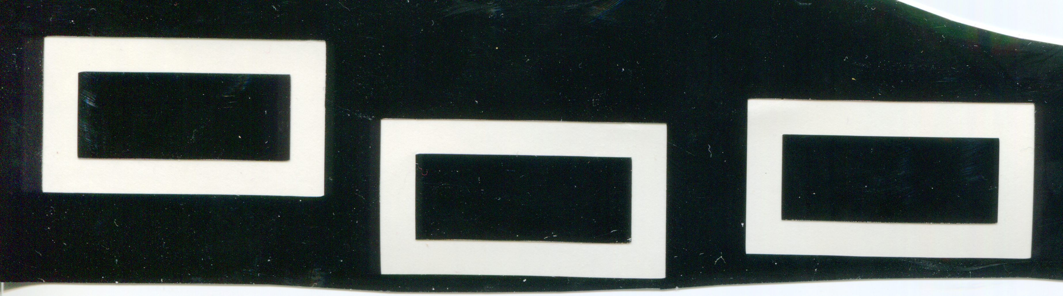

Larryc39 0 Posted December 21, 2019 I've had this machine a long time, rarely used it, always cut good. Now, it's rounding corners, leaving tags or tails, etc. It's not a S/W offset issue, if I try the machine standalone in test mode it'll do the same thing on vinyl or on paper w/pen. What can I do to make this machine usable again? Share this post Link to post Share on other sites

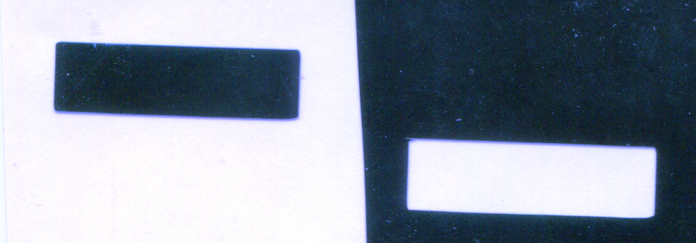

Larryc39 0 Posted December 21, 2019 It's not a software issue. I experience the same "offset style" issue when using the self-test test pattern print feature without a PC connected and it is the same issue if using a pen or a blade. In my original post, I've included a pen sample from using the built-in test on the cutter (makes a 1 1/8" x 5/16" rectangle). In this post I've attached a vinyl cut sample. Both are done directly from the plotter, no PC involved. I don't know of any way to adjust the offset on a Laserpoint 24, only to adjust the scaling size of the output by the X and Y axis. Share this post Link to post Share on other sites

Larryc39 0 Posted December 21, 2019 It seems to be cutting acceptable now. Corners are good enough. It's been so long since I used it I was thinking the software offset was to compensate for issues in the software - not compensating for mechanical inaccuracies in the cutter. Thanks. Share this post Link to post Share on other sites
MZ SKEETER 4,727 Posted December 21, 2019 Yes, looks much better. Your welcome 1 Share this post Link to post Share on other sites
