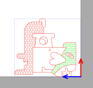

If I select only the colour I want then it defaults to putting the artwork at the origin point, not where it is in relation to the other layers.
Is there a way to import a layer and keep the settings of the artboard in illustrator, or any other way that you can keep the position of different layers?
All colours selected:
Just green selected:
As you can see it jumps to the corner…

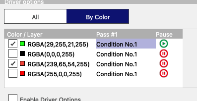

Ok, so I think I just worked it out!
Looking in this panel:
I can pause the different colours and then switch out the pen before continuing!
Hope this helps if anyone else comes across this.
