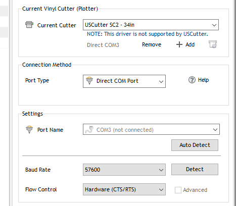

MZ SKEETER 4,727 Posted March 18 After installing and running the driver, reboot your computer. Go into your device manager on computer, Look for the com port # your driver choose. it must be between 1-4, nothing higher. If not then change the number to 1-4. Then go into VM> DIRECT COM and choose the same number. They must match. This cutter is not TRUE USB like the Graphtec. Quote Share this post Link to post Share on other sites

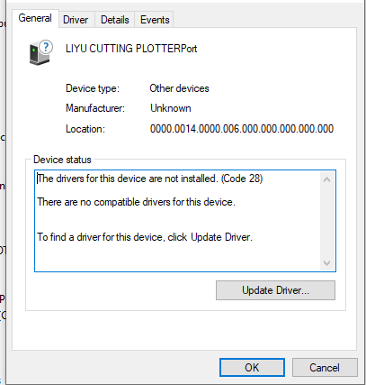

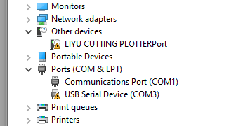

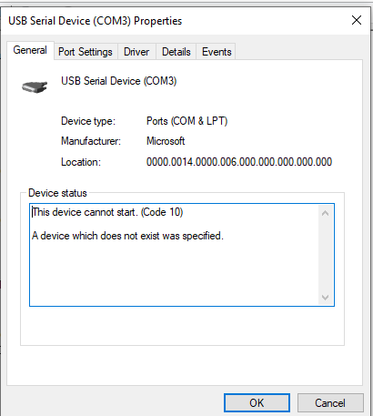

PawPaw30157 0 Posted March 19 After installing and running the driver, reboot your computer. Go into your device manager on computer, Look for the com port # your driver choose. it must be between 1-4, nothing higher. If not then change the number to 1-4. Then go into VM> DIRECT COM and choose the same number. They must match. This cutter is not TRUE USB like the Graphtec. When loooking in Device Manager, I see two things that populate once the cutter is turned on: "Other Devices - LIYU CUTTING PLOTTERPort" and 'Ports (COM and LPT) - USB Serial Device (COM3)". However, both of these have the cuation icon on them. The first one says the "The drivers for this device are not installed" and the second one says, "the device cannot start. A device which does not exist was specified" Again, I have downloaded the drivers and loaded them - several times. Quote Share this post Link to post Share on other sites
MZ SKEETER 4,727 Posted March 19 You have never stated which operating system that you are using. Go online and find the correct FTDI driver for your operating system and make sure it installs correctly. You are rebooting your computer after running and installing the driver, Correct? Possibly show screen shots. It's COM 3, Do the rest of the set up now. Go into DIRECT COM. Match Com 3 Don't use Detect. Use DIRECT COM. Once done you cannot keep changing the ports on your computer. Every time you change the com port, you may also be changing the com port number in your computer device manager, then the com port numbers will no longer match. A Tripp-Lite Keyspan Adapter, is also highly recommended on value cutters. That is the brand name. You use it with the null modem cable that came with your cutter. it has it's own driver to connect with. Much better connection, than the cheap Chinese chipset in the value cutters. if that doesn't work, contact UScutter tech support when they are open. Pacific time. Quote Share this post Link to post Share on other sites

MZ SKEETER 4,727 Posted March 19 Have you gone into, the device manager, COM 3 properties and made sure the driver is correctly installed? No Yellow checkmarks? You mentioned Caution icons above. Can you show screenshots? Quote Share this post Link to post Share on other sites
PawPaw30157 0 Posted March 19 Have you gone into, the device manager, COM 3 properties and made sure the driver is correctly installed? No Yellow checkmarks? You mentioned Caution icons above. Can you show screenshots? I have followed all advice for getting this repaired. I have installed the driver several times. The driver is up to date - per the system. The funny thing is that the driver was downloaded from this software. Also note that COM3 is greyed out. I am currently on hgold with US Cutter Quote Share this post Link to post Share on other sites

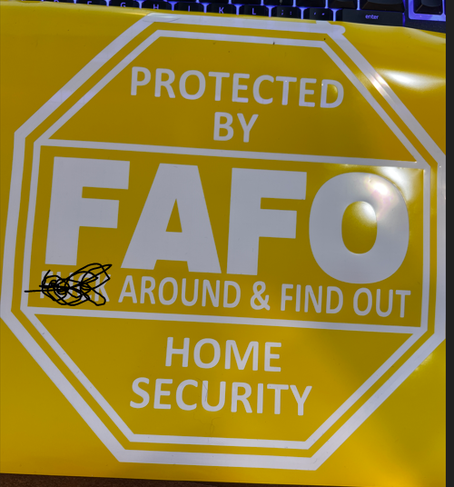

PawPaw30157 0 Posted March 19 I'll give the same advice as recently offered to another person having COM (usb) issues. STM32 vcp https://mydrivers.online/software/stm32-virtual-com-port-driver andhttps://quadmeup.com/stm32-virtualcomport-driver-for-windows OK - I installed the STM32 vcp and this worked perfectly. I was able to make my first cut. THANK YOU slice&dice. I scribbled out the F-bomb as I don't know if that is allowed in her or not. I will be making a bunch of these in blue. I used yellow for this one as it if my least liked color and I had some laying around. Now I just gotta learn the software (just CUT for now) and then upgrade to PRO.... Where is the best place to get videos for learning the suftware? Obviously YouTube, but what channel? Quote Share this post Link to post Share on other sites
