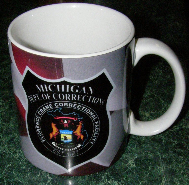

Dakotagrafx 7,298 Posted November 27, 2018 Here is one I did with a mug press and got the fade at the bottom - the mass acts as a heat sink and wicks the heat away 2nd one is with cactus wrap last one with wrap for one of the OCC employees with a wrap Share this post Link to post Share on other sites
