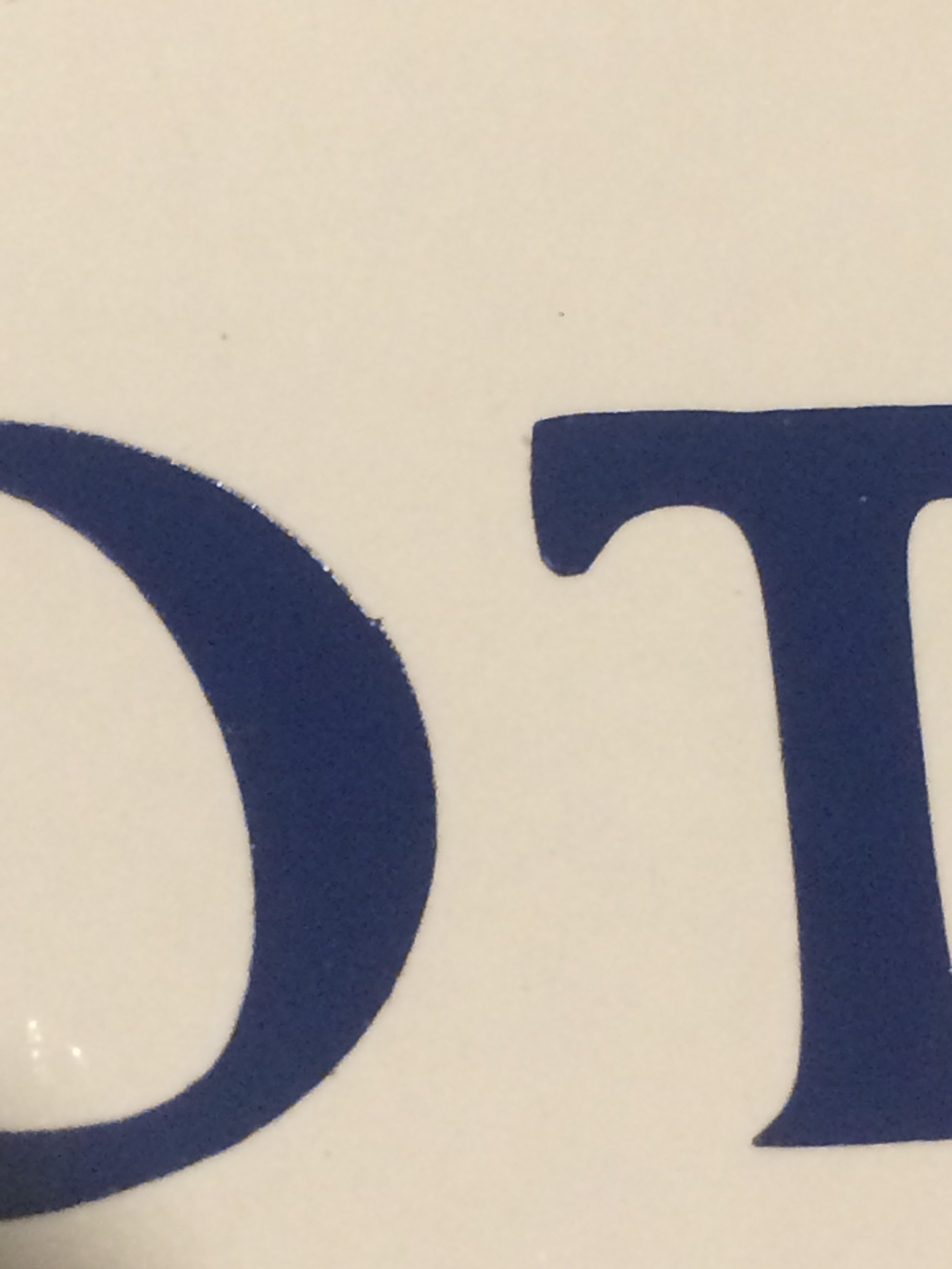

justso12331 0 Posted April 1, 2017 Anyone know what causes the machine to cut and not completing cut . Posted pics of it. The corner of the o looks like the photo of the p. Any help would be appreciated. I'm using scalp Share this post Link to post Share on other sites
Dakotagrafx 7,298 Posted April 1, 2017 add a bit to the overcut in your software 1 Share this post Link to post Share on other sites
justso12331 0 Posted April 1, 2017 Will try it soon as I get home and let you know.thanks Share this post Link to post Share on other sites

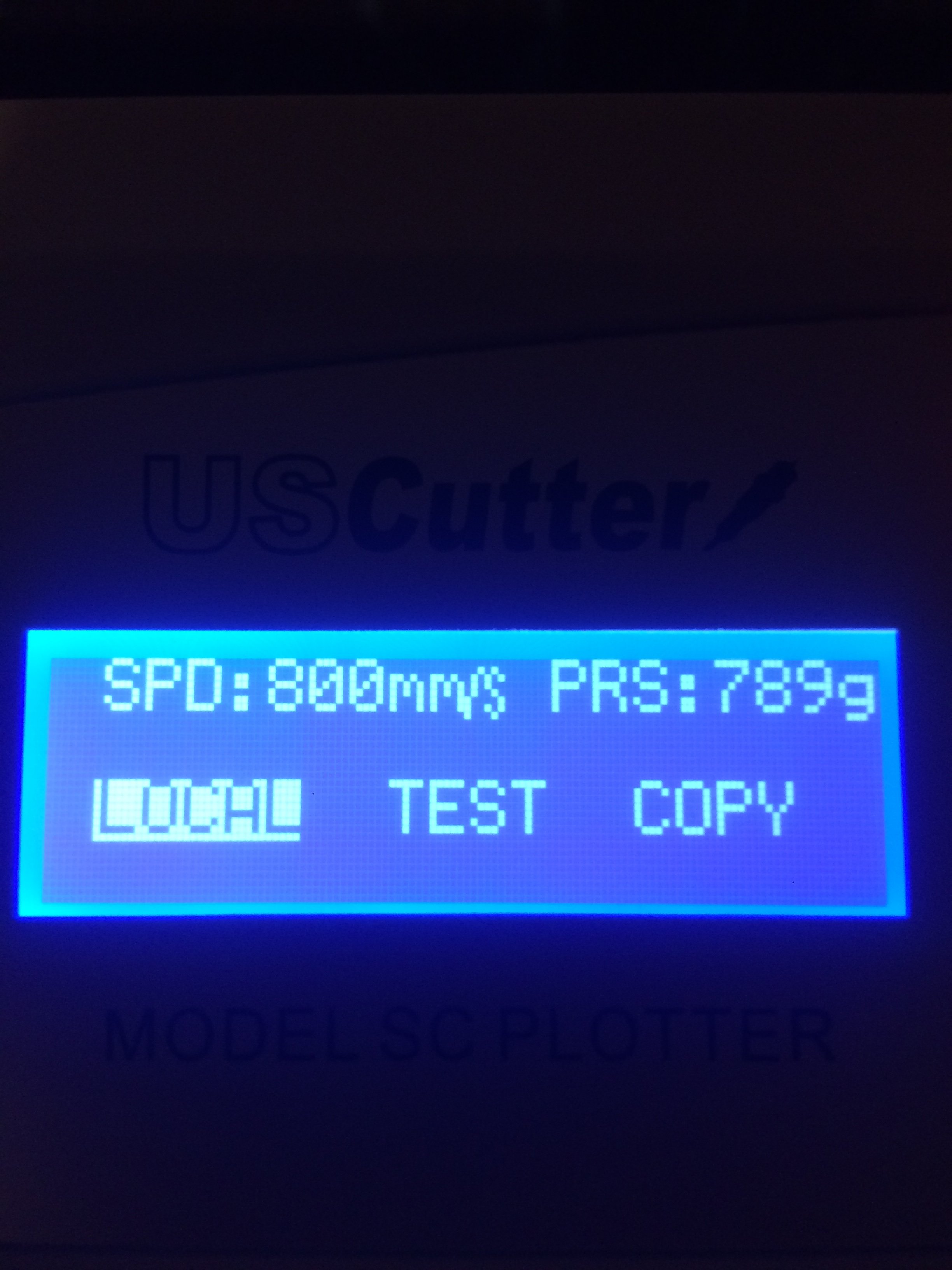

xpaperman 719 Posted April 2, 2017 maybe off topic but it looks like your speed is a little fast and you are using alot of pressure for regular vinyl. 3 Share this post Link to post Share on other sites
dcbevins 340 Posted April 2, 2017 12 minutes ago, xpaperman said: maybe off topic but it looks like your speed is a little fast and you are using alot of pressure for regular vinyl. Yeah that's fast, but if it works it works. I go 300-400 speed, 200 if it is something I feel I have to heavy babysit. I go 90 grams for pressure most of the time. If you hare having to hit almost 800 grams to get proper cuts, something else is wrong like blade depth. That is alot of pressure. 1 Share this post Link to post Share on other sites
Wildgoose 4,200 Posted April 2, 2017 10 minutes ago, xpaperman said: maybe off topic but it looks like your speed is a little fast and you are using alot of pressure for regular vinyl. Totally agree. Slow it down to something like 200mm/sec to start off and gradually increase your speed to the point you are happy with it. Your car is probably capable of going 120mph and it may be fun to run that fast once in a while for the thrill but think about how hard that would be on the components if you were to drive it that way all the time. Your cutter is built by people probably making a couple bucks a day out of about the most cost effective (spelled cheap a$$ in english) parts they can conjure up so going full speed very often is budget cutter suicide. 1 Share this post Link to post Share on other sites
xpaperman 719 Posted April 2, 2017 5 minutes ago, dcbevins said: Yeah that's fast, but if it works it works. I go 300-400 speed, 200 if it is something I feel I have to heavy babysit. I go 90 grams for pressure most of the time. If you hare having to hit almost 800 grams to get proper cuts, something else is wrong like blade depth. That is alot of pressure. Thats about where I was with my SC 1 Share this post Link to post Share on other sites
justso12331 0 Posted April 2, 2017 Ok I lowered the speed 300, and the pressure to 85. I also messed with the overcut, I'm pretty sure I've got it close to cutting normal, just gotta fine tune the settings. I appreciate all the help thanks everyone Share this post Link to post Share on other sites
