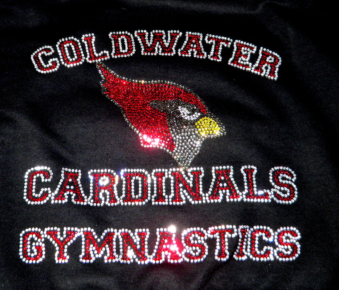

Dakotagrafx 7,298 Posted March 24, 2017 3 minutes ago, MonkeyMeMe said: I always cut two passes when cutting Flock,just to make sure no lil fiber hang tag is present, in another thread we learned that they was pressing HTV Flock onto sign vinyl and cutting that - being the rhinestone queen, have you ever heard of that? PS This is some of sandy jo's work from a while back she made for me 1 Share this post Link to post Share on other sites
