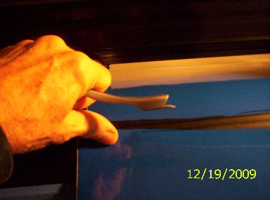

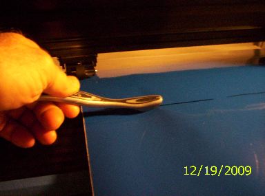

Karl 0 Posted December 28, 2009 tip there are several brands, this one is by Scotch, it is a standard xacto blade in a protected holder, I have not yet tried to replace the blade, but it looks like you just use needle nose pliers and pull the old blade out, put a new one in. you just slide it along, it cuts, you have a reasonably straight cut. works great for trimming off cuts between jobs, when leaving vinyl in the cutter. Share this post Link to post Share on other sites

Booper 2 Posted December 28, 2009 I use something very similar, its one of those cheap plastic letter openers with the tiny razor blade in it, the narrow pointy bit goes under the vinyl and sits in one of the slots on the front of your cutter to guide it along and then you just push. cuts it dead straight everytime which makes lining up the roll next time alot easier. Share this post Link to post Share on other sites
