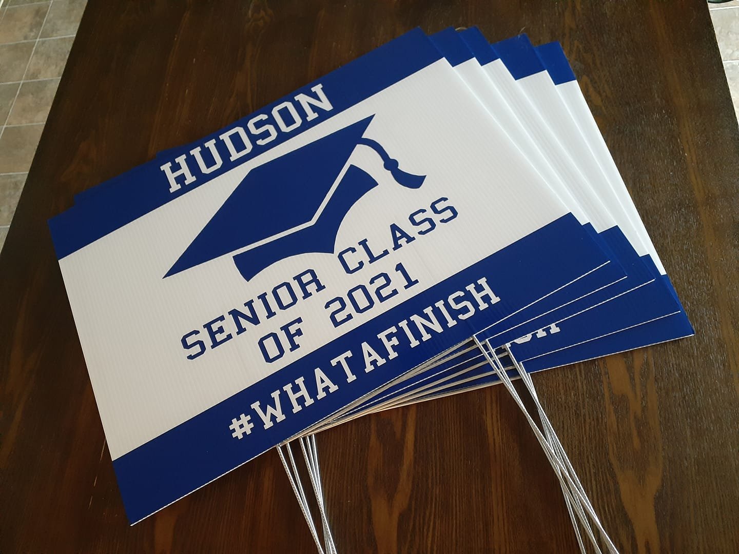

It's that time of the year again! I made a metric ton of these last year for the 2020 grads. Someone who bought one last year from me also has a graduate this year and wanted the exact same one (with a different hashtag and year) so I made them one. I posted it on Facebook this morning and by 10 pm I have 15 more orders! I expect many more orders once more people see them. Already placed an order with USCutter for more vinyl, blank signs and stakes. I hope I have enough transfer tape to last, they were out of the 24" Greenstar I usually use...
These things sell themselves!
