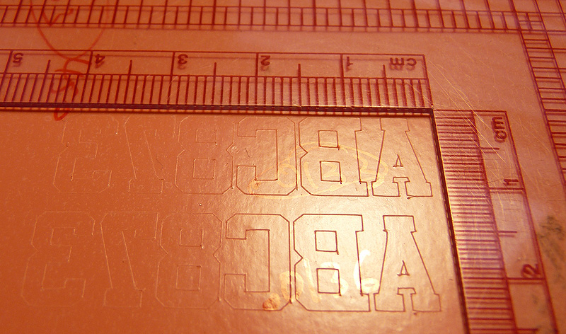

Raw7 0 Posted May 12, 2010 Alright I just tried it and it worked perfectly. I took it right out of the copam and dropped it into the LP and did not have to make any adjustments at all and it cut perfectly. So the LP should be able to cut just as good as the copam now. I've been trying to cut text smaller than half a centimeter and it's quite difficult to get the settings correctly. I've played with the blade offset and still haven't been able to cut a decent detailed small text. And I'm making adjustments in increments like this: .0011 to .0013 to .0015. For example on my attachment, at 1cm, the cutout isn't bad. You'll notice slight slants on the lower leg of the inside-right of the "A" at 1cm. On the smaller cut (about .8cm), you can see major distortion at the same location - lower leg inside-right of the A and at the top of the A. What am I doing wrong? Does the X-Y settings come into play as well because I feel I've exhausted the Offset settings going up and down without success. The smaller cut was made with the same settings as the larger 1cm cut. Also I am cutting at very slow speed (20 on the LP) Any insight is appreciated. Share this post Link to post Share on other sites
Dakotagrafx 7,298 Posted May 12, 2010 yup make enough money with the LP to buy a roland or Graphtec - problem solved. the cheaper cutters were designed to sell cheap - they work well but for fine work you will be a lot happier with a name brand cutter. Not trying to be mean as I started with a p-cut and transitioned thru a refine, copam to the graphtec - each paying fro the next and steadily improving in small cuts and accuracy Share this post Link to post Share on other sites
Raw7 0 Posted May 12, 2010 So that's the difference with more expensive cutters? I thought I was going crazy making all these adjustments without improvement. Good to know! Share this post Link to post Share on other sites
