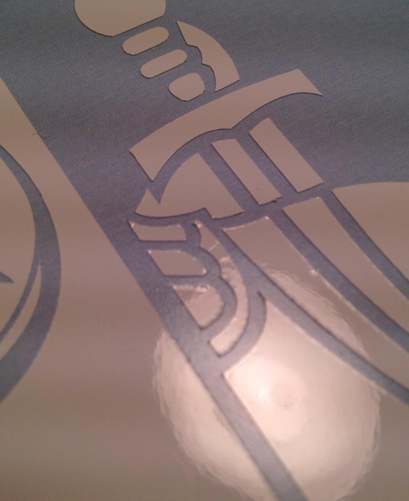

No, I changed the blade three times. Set it back to where it was working perfectly for a different type of vinyl. Now that is screwy. As far as "trying to make it do something it wasn't made to do", I thought it was a die cutter? If It can't at least cut straight edges then might as well use a real scalpel!
I'm very new to this, not 100% on all the settings, offsets, overcuts, pressues, speed and how they all correlate with each other so bare with me.
Just trying to cut a simple graphic. It may not be a square but if I was cutting squares all day I would get a straight edge and xacto.
I have already been through about a yard of vinyl, scraps and all and it still leaves jagged corners. New blade, light oil, set the depth a few different time, still no go.
What a nightmare! Now when I set it back to my normal cutting it's all screwy...
Ok, tried to mess with the overcut. Now at my last settings it's starting to make the text look cartoony instead of being straight. Trying another blade and some light oil.
The entire decal is 5" tall. Hard to describe the area exactly.
I'm going to try a new blade and some light oil as suggested. I have tried several different offsets and pressure settings, some are starting to look jagged!

I've messed with the offset as well as blade depth. The parts are completely cut, just in certain areas it looks like the vinyl is getting snagged and causing irregularities. See attached picture.
My pressure is set at 42, speed is cut at 200 and offset is at .60mm. Only reason why the offset is set at 60 is it works fine for avery yellow paint mask, just not oracal 7511

Well, the offset is set at .60mm! It works, that's all that matters!
Thanks for the advice!
