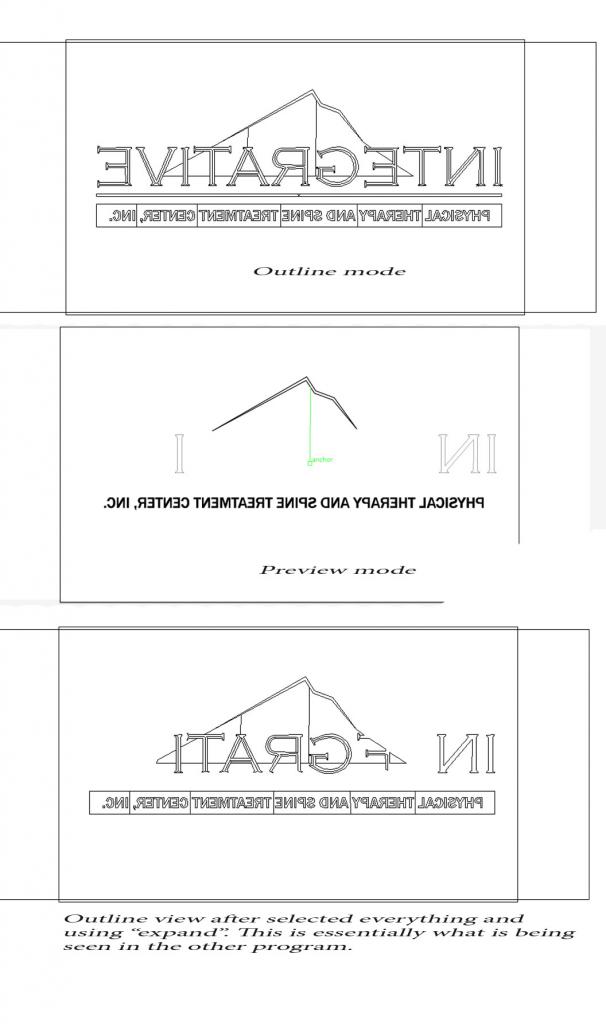

I will try and attach the file. I'm sure it's something simple. If you look the part that is missing is actually outside of the mountain area. It's going to be airbrushed onto plexi so the bottom of the mountain doesn't really exist. it just fades of. The cut line is just there to expose the area but not the surrounding area. Thanks for the input.

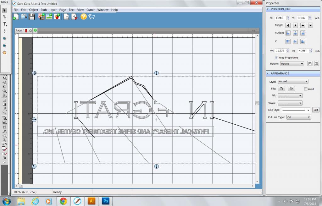

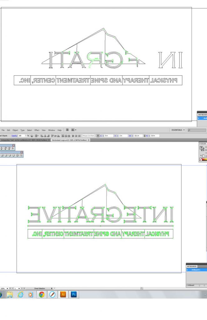

In Outline mode of AI my image looks fine. When i export it to SCALP it loses part of the image (and distorts some lines). I notice if use "expand" in AI I get the same loss. I upgraded to the newest version of SCALP but I don't think that's it. What's going on and how can I fix it. I need this file ASAP for a job.
tried SVG, SVG compressed. I tried saving it with every option AI had to save it in. SCAP didn't even recognize some of the files and the ones it did had the same distortions
. I contacted the customer support so we'll see if they respond and what they say.
I'll see when I get home. I am using CS5 as well. It seems to be distorting a lot of files, not just this one. They are small sized files since it's for an RC car but why most paths are good and some distorted is still a mystery. I tried saving the in AI last night in every file type available and either SCAP couldn't read it or the same errors were present. This occurred on two totally different files. Probably not something there is an easy answer too. I'll have to get over on the other forum and see what they say since that is where the developers are.
treid downlaoding and istalling that file, still same issues. What file type do you guys use to go from AI to SCAP? Guess I'll post up on there forum too.
No, it actually cuts it like it is, with the distortions. Is there an optimal file type to "save as" in AI for importing to SCAP?

I have an Illustrator file that is perfect in Illustrator's Outline mode. When i import it SCAP distorts some of the paths and even leaves one out. ANother file also perfect in Illustrator when I open it it's blank with no visible paths. Anyone else having this issue? Any solutions? I've already tried opening and closing both programs, even restarted the computer. I also made a tiny modification to the distorted line just to see if it would recalculate and draw it properly but it didn't (though when I removed the buldging path it did reflect that it was removed - though when I put it back correctly it distorted it upon import again).
