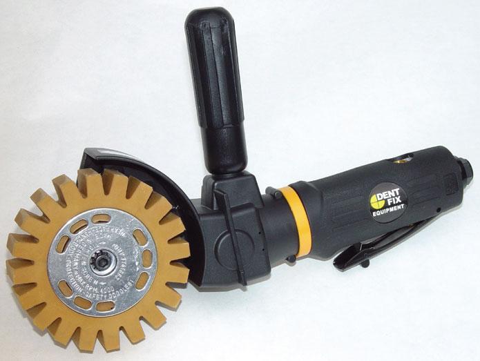

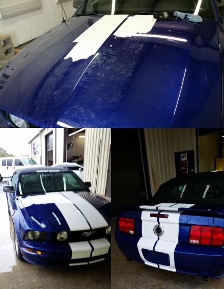

jmas 119 Posted October 29, 2015 Well, I finally got time to do it and it turned out ok but I think I'll use wrap vinyl next time. I was a little upset to find out that the place I work doesn't have an eraser wheel and spent two hours trying to get the hood stripe off. That's the first pic. Luckily I borrowed an eraser wheel and zipped the rest off in 10 minutes. 2 Share this post Link to post Share on other sites
mr300s 1,272 Posted October 29, 2015 That looks great Share this post Link to post Share on other sites
Primal Decals 621 Posted October 29, 2015 If it were me and i have done it ,Is i use a digital heat gun on low setting and ive just peeled away the vinyl.Then i actually use wd40 on the residue left over and wipe it off with a non scratch cloth,then come back with Rapid prep for the cleanup for new install.Works perfect for me with no issues. Ive tried the eraser wheels etc and didnt like the outcome .....But that looks really good . nice job.. Share this post Link to post Share on other sites
Moody Blue 505 Posted October 29, 2015 Looks good. Yes I would not have done that without wrap vinyl. I just LOVE the ease of wrapping with Avery SW900 Share this post Link to post Share on other sites
jmas 119 Posted October 29, 2015 If it were me and i have done it ,Is i use a digital heat gun on low setting and ive just peeled away the vinyl.Then i actually use wd40 on the residue left over and wipe it off with a non scratch cloth,then come back with Rapid prep for the cleanup for new install.Works perfect for me with no issues. Ive tried the eraser wheels etc and didnt like the outcome .....But that looks really good . nice job.. That's my preferred method but it wasn't happening, the vinyl was super dried and cracked. The car was an '05 and it must have been factory vinyl or applied soon after. The pile of white stuff on the ground is the few inches of vinyl from the bumper. I'd peel half and inch and it would break. And the bumpers were the easiest panel to do! Working at a body shop, I'm used to using eraser wheels and they work well for me. But not the disc types, the wide paddle wheel erasers are the only ones I'll use. 1 Share this post Link to post Share on other sites
