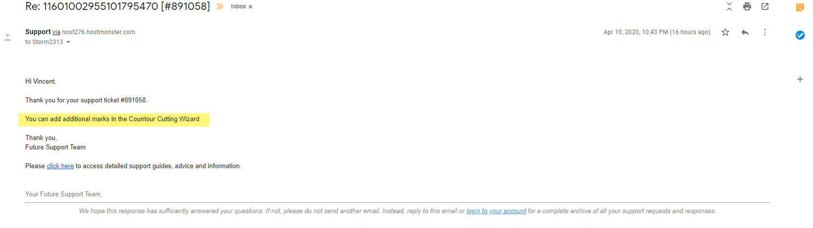

I've started printing longer sheets of vinyl that require contour cutting, and realize my contour cut lines accuracy when cutting aren't as accurate. Their off by (.006in-008in) randomly around the artwork.
I want to add additional registration marks in Vinyl Master for using with my Graphtec's ARMS feature. I see you can add ultra marks under the manual selection under the contour cut feature, but you can't add them while using the ARMS feature.
If someone understands how to add multiple registration marks while using the ARMS feature, and will explain the process I really would appreciate it. I'm using Vinyl Master Expert Edition.
I've already opened a support ticket, and the response from Vinyl Master is actually really sad considering I was expecting a logical response with an explanation of the process of course especially considering the cost of the Expert Edition.

Using ARMS And Adding Multiple Registration Marks?
in VinylMaster CUT, LTR, PRO & DSR
