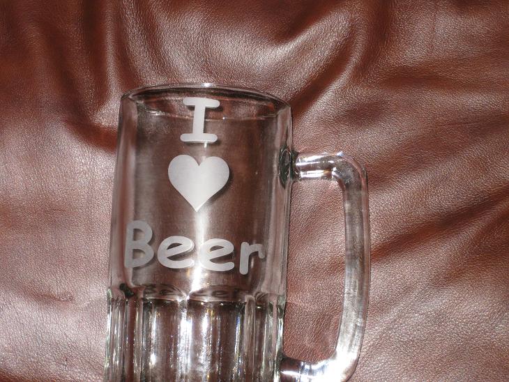

This thread inspired me to give it a try too. I figured it's not worth starting a new thread over.

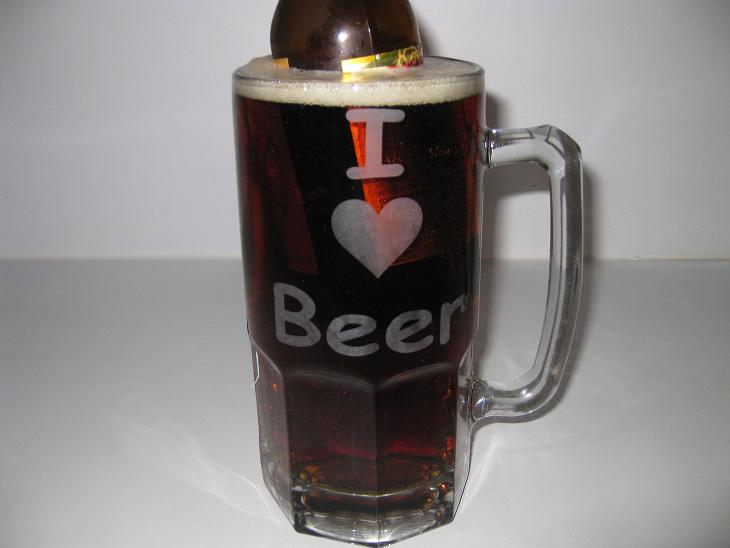

$5 giant beer mug from Garden Ridge. Took about 20 minutes from sitting down in front of the computer to filling the mug with beer. (That's 2-12 once bottles in there and it still wasn't enough to completely fill it!)
Looks like you just put vinyl on it?
Not sure what you mean. I used some old plain white no-name vinyl as the stencil, but what you see in the pic is the blasted finish. I used an air eraser to 220 aluminum oxide.

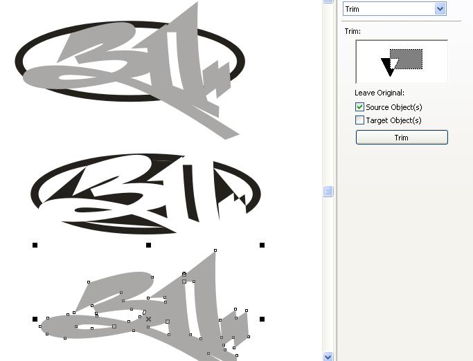

Seems like it should be simple....I want to trim the black oval so everything that is under the gray is deleted and I'm left with basically three new separate black objects. I tried Arange->Shaping->Trim and I'm left with the object shown in the middle....basically it's trimming it and making it one object instead of three, which is a PITA to clean up
Is there a function I can use that will actually make new separated objects?
