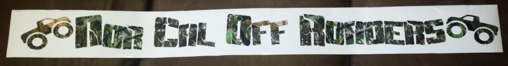

I did skeeter. Its just when you start pulling it up, its so soft in the fine line areas ,the vinyl breaks . versus the oracal . i can just pull and go.I can get the oracal done in under 8 min. The camo well i wont say lol..
hmmm . i remember seeing that as well.. Thank you guys for all your input .. Just not liking the camo right now lol..
lol have fun with that Phaedrus,curious how it goes tho, let me know - i had people want pink camo vinyl as well but after this ordeal i would have to charge more.but the weeding is dang near double to triple the time. right now for my white vinyl 4" tall by 35-40" long using oracal 651 im getting $35 each installed for these.the camo i bumped it up to 40 ..there is a few sign shops etc here but they are charging $40 for the same design in the same material but charging $90 min for install no matter how small it is.
PhaedrusZen, Its only with the camo im having the issue of not seeing the cuts, Ive been cutting this and weeding with oracal 651 and it comes off with no problem and the lines just pop out on my light table. but this 3m control tac from fellers is way different.i figured that if i lift my table at about a 10 degree angle. the lines are easier to see, but it still weeds a lot different than my oracal stuff ..the camo is way softer stuff as well .
the font isnt fun at all.. Im doing this for a off road group and its been all white till i mentioned camo lol. i have awesome lightbox i made and its been perfect.but with this vinyl it kinda self seals itself and the light wont go thru at all.if you are getting the vinyl from fellers ask who is the rep in your area and they will help you out .. I ended up taking my led light from my cutter i use and actually it helped more than i thought it would, I can actually see a little more of the lines but not like i want lol..
