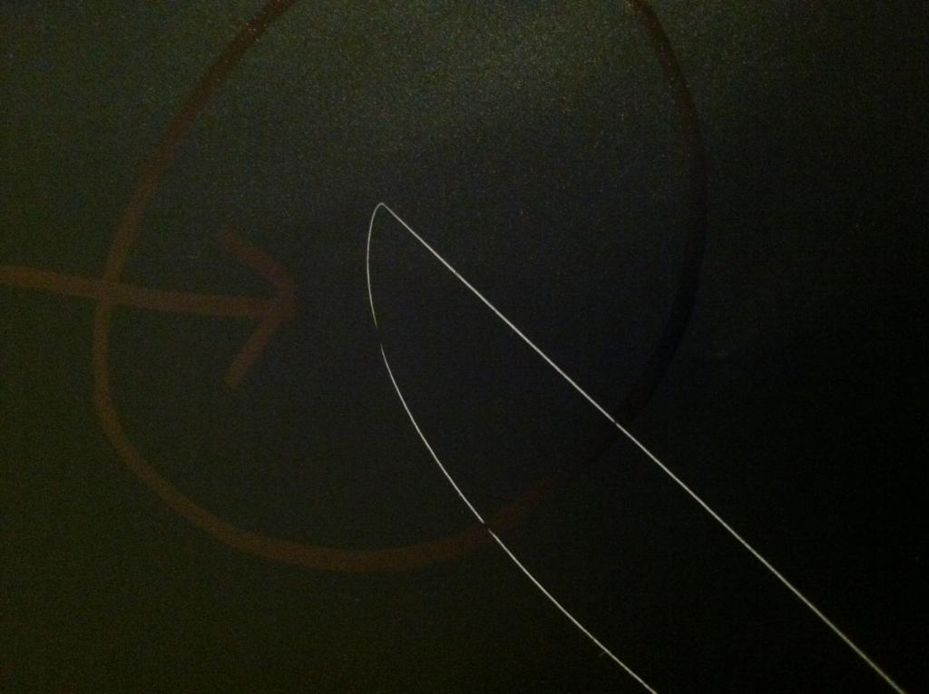

When I cut my designs out, or whatever I am cutting, when the blade is on ONE segment/shape, and about to finish cutting that object and move to the next shape in the design, the blade is cutting the shape, but not completing the shape and leaving a 1-2mm area where the beginning of the cut didnt meet up with the end of the cut, so when I go to weed the design out, i have to handcut that small portion to weed out the shape. Make sense? (See Attached Pictures)
I was playing with OverCut, and stuff like that, but none seemed to get it dialed in. I also noticed that when its going from one shape, to the next at the end of the cut the plotter blade moves from one object to the next REALLY FAST. Is there any way to SLOW this down? Even when the speed is on the lowest speed possible, it still makes no difference, and goes from shape to shape not finishing the shape cut and still moves too fast.
HELP! Thanks in advance! -
HELP! Thanks in advance!SEE ATTACHED PICTURES BELOW.
