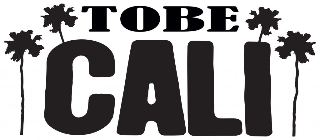

I really like my logo , since it more than a statement then an actual logo. Thats why I was looking for a way to simplify the cut for my cutter.. and I think I found it.
I just deleted some of the extra "cutting points" in Scalp which didn't change the shape of the palm trees too much so the cutting is simpler, but the shape remains for the most part.
I really hope these shapes don't effect the cutter like you guys say..

@djque I'm working on a new logo ( a simpler one) to preserver the life spane of my machine when it come to cutting those palm tree leafs ..
as soon as thats done I'll try the Week Box..

I'm amazed how detailed the SC Cutter cuts. Please take a look at my pictures attached ..
Now I will just have to find out how to set a cutting line around my logo, so I can actually remove the "negative part " from around my logo..
.. I'm assuming you call it excess vinyl !?.. and put it on application tape.
I'm a little bit concerned about how much the machine has to move/work to cut out my logo so detailed, since this will be the shape I will cut the most. That can't be good for the machine . I'm thinking about changing the leafs of the palm tree to a simpler shape to not mess up the cutter over time.
