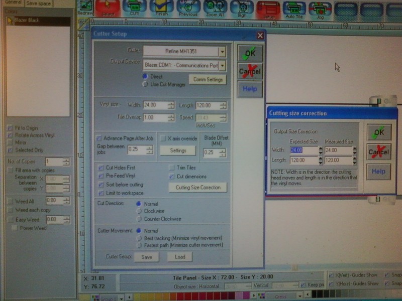

I am trying to cut racing stripes for a customer which measure 20" wide by 72" long. Now when I go to cut this and the machine prefeeds it should move across the vinyl very slow compaired to the rollers because it is only supposed to move 20" but instead it moves just as fast as the rollers and will not stop moving across the vinyl infact if will move all the way across the machine until it hits the otherside of the machine if you let it. Now if I make the length 65" or shorter it is just fine and works great but any length over 65" it will do this crap. Why would my length be making my cutter do this when it's the width that the cutter is supposed to be measuring across? Any help would be great thanks

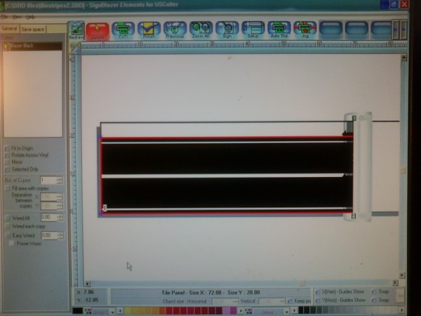

It's just a customers phone number so I am not going to put a customers phone number on here. I have my work area set to 24" tall by 96" long and the 11 digit number 1-715-625-4785and the number size is 12" high by 90" long. This should be an easy cut but for some reason it doesn't like the length. I tried it at 5" and no problems but longer it does not like.maybe put up some screen shots of your layout screen before sending to cut, we cannot see what you are doing , just by you saying so.. Show it..

I have them both at 15" by 120"it can affect it.. also static. does the CUTTING SIZE CORRECTIOn in set up match each other OUTPUT SIZE CORRECTION, measured size, expected size?

It's just a customers phone number so I am not going to put a customers phone number on here. I have my work area set to 24" tall by 96" long and the 11 digit number 1-715-625-4785 and the number size is 12" high by 90" long. This should be an easy cut but for some reason it doesn't like the length. I tried it at 5" and no problems but longer it does not like.maybe put up some screen shots of your layout screen before sending to cut, we cannot see what you are doing , just by you saying so.. Show it..

Ok I have the Refine MH1351 cutter and it has worked pretty good thus far. What is happening is I am trying to cut a phone number 12" high by 90" long on 15" vinyl. I line the cutter up to it's start position and when I go to cut it starts it's prefeed as normal but instead of stopping at 12" it just keeps going until it hits the otherside of the machine. It works fine with shorter lengths but longer stuff it has troubles. So why during prefeed on longer lengths does it not stop where it should? No I do not have the X and Y measurments backwards either. Thanks I use sign blazer
