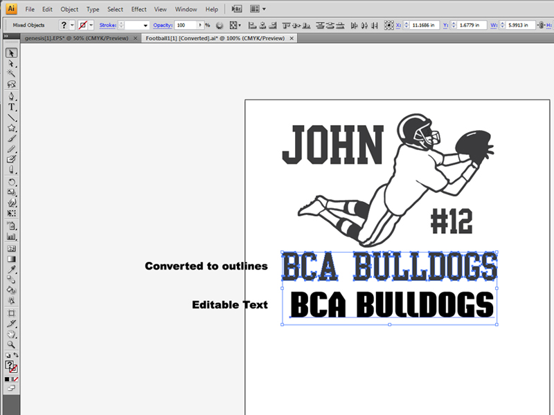

The text in that file is already converted to outlines. Meaning that it is now an object...not editable text.....Editable text in illustrator will show up as text with a line under it and will not be outlined.
Easiest way to understand would be to open that file in AI...click your text tool and type out some text close to where the current text is (so you can compare the 2).
Now if you select the text you just typed...then select the other text..you will see the difference.
Heres a pic to show ya...hope it helps

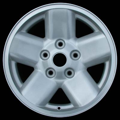

Im sure there is a simple trick to this, but my teeny brain just cant seem to wrap itself around it.
Basically I need to know how to make a template from an object...in this case lets say a car wheel. So that when i cut it, it is the exact size/position etc.
I have no problem taking an image into illy and drawing over it etc. But, when im ready to cut it..i need it to fit. (basically a skin for an object.)
Heres an example..This is the wheel on my truck and say I wanted to `skin` it..I would need the `legs` of the image to match the rim..make sense?
Measuring the circumference of the wheel is a given, but getting the inner wheel to completely match (lug holes, legs, etc) is gettn me.
Hopefully somebody has an engineer type brain that can ramble off how do accomplish this
