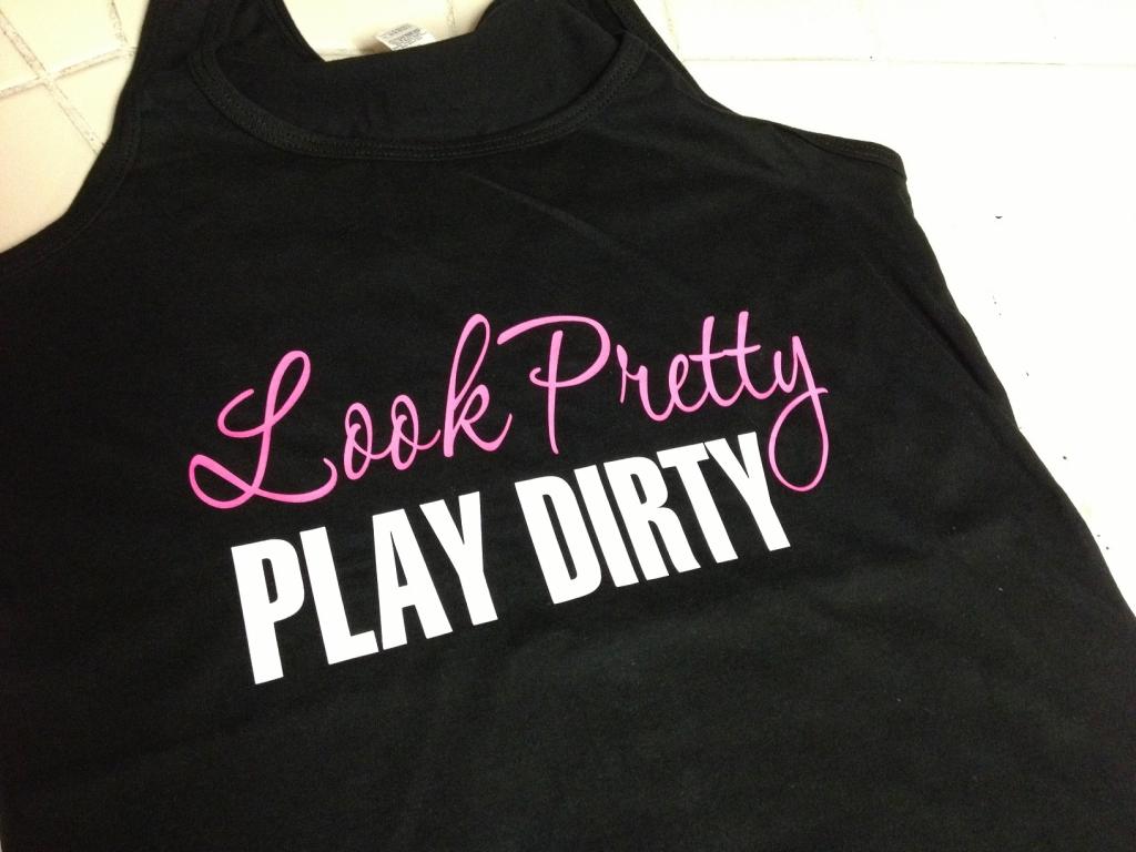

I just did 10 of these for a ladies group doing a "Mud Run" no ribs/smooth. Descent quality and they have a pink.
