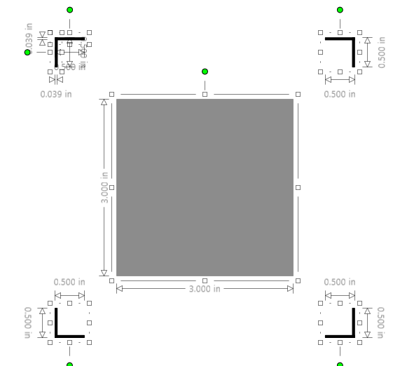

Yes, you have to change the design between the first and second cut. Better yet, use two files. Here's the first file.
Let's say the square is the thing you want cut out. You add reg marks with the software so it adds those 4 brackets. My software says the brackets are .5in in size, the lines are .039 thick and they're placed 1 inch from the design. If you printed this in a printer then put it in a plotter, the plotter would look for the reg marks and cut out the design inside them. Since you don't have a printer, you can make those brackets out of vinyl. Save that as file1.
Now, design your own reg marks that match the ones the software added and place them where the other reg marks were. Here I've made 4 bracket shapes with the correct dimensions and put them 1 inch from the design. Save it as file2. Send file2 it to the plotter and it will cut out 5 shapes in the vinyl, the square and the 4 bracket shapes, because it doesn't see the brackets as software created reg marks, they're just part of the design.
Then you can weed the vinyl, apply it to the magnet and put the magnet back in the plotter. The magnet has the vinyl design and 4 vinyl brackets on it. Open file1 and send it to the plotter and the plotter will look for reg marks and cut out the square. The reg marks are just made out of vinyl instead of being printed.
