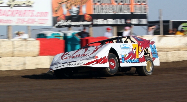

This was it's 7th time on the track. 2 hotlap sessions, 2 heats, 3 features. Not a peel in sight yet. It gets washed tomorrow (pressure washed, clay sticks like glue), will know more then.
The one area that has impressed me the most so far is the nose graphics. That is a plastic piece and it is always a challenge to get it to stick. It has had a couple weeks of adhesion time but so far so good. I sanded the plastic and then cleaned it twice before it was applied. I really expected it to start coming off by now. Previous years we got 2 weeks out of a contingency sticker on the nose, 2 weeks now and all is good. The right 1/4 had a encounter with a concrete wall and the greenstar held up as well as anything else I have used.
Like I said before longevity is not a issue with this type of racing, I will go through 2-4 sides a year. Cost factor is what I am worried about. The greenstar cut and applied as easy as any oracal I have ever put on (except for the fluorescent blue, that stuff is a real pain in the posterior).
