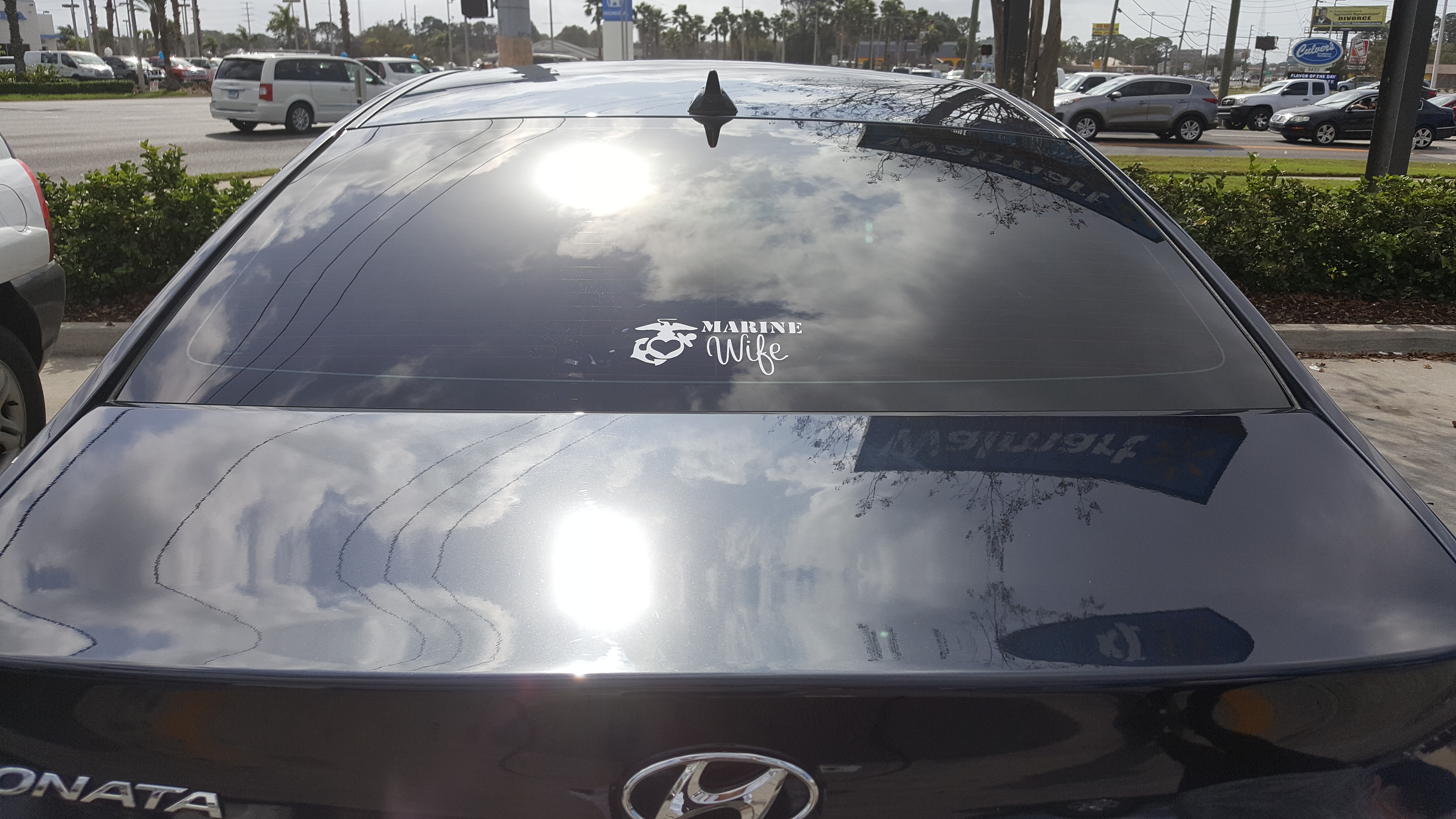

Thank you guys, appreciate your help after 2 weeks of fighting with it I finally figured it out now I feel stupid carriage was off the roller cutting great now will be posting pics soon.
