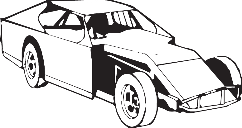

IMCA MOD WPC
in Vectorizing
Thanks but it wont work for me. I need one already saved as WPC file. I can not convert
