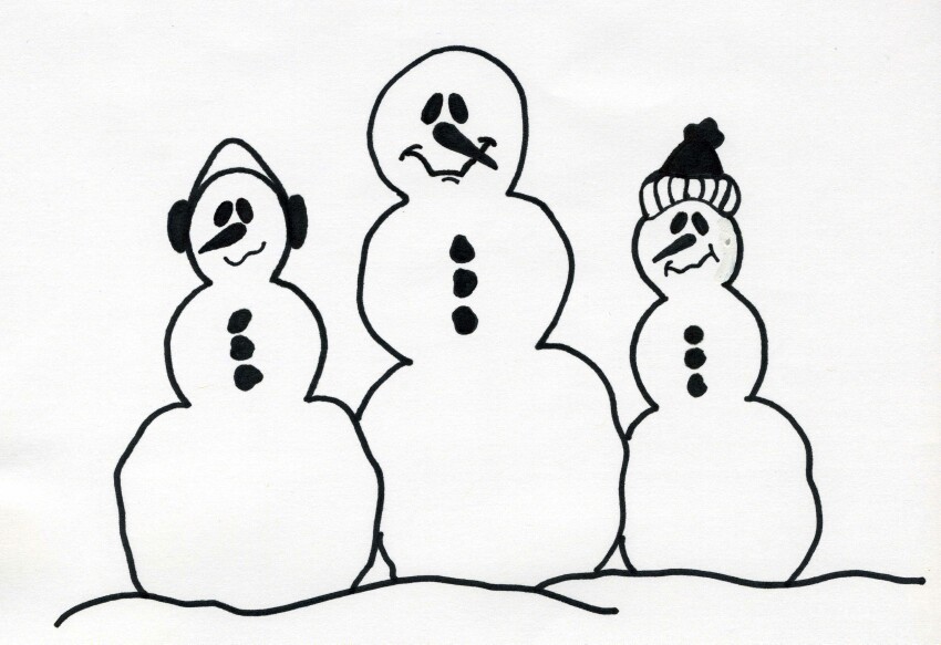

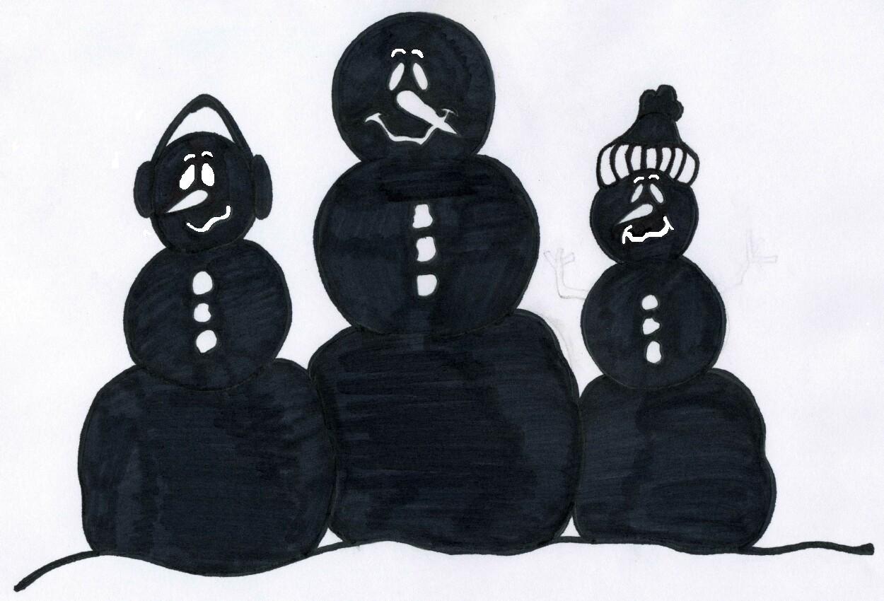

I wanted to let you know that I tried one of the vecotized snowmen( the ones that were vectorized in this forum for me) and tried cutting them directly from Signcut. One cut just fine (the 2nd version) but the 3rd version, that has more detail, started cutting and then did the same thing by dragging the blade through the project and then froze up.
Thanks for looking at this for me.
Pianomom
Here are a couple of the projects that seem to be causing me go to bald!
The snowman project was where I had gone into Inkscape and had it trace the bitmap. (It is not the vectorized graphic that was done for me). Seeing that there were lots of nods I just figured there was too much info being sent to the cutter, but the other two projects are either just fonts or a font with a small graphic. The project would start to cut and then part way through just drags off to the side of the cutting area. I really appreciate your kindness in looking at these. I look forward to learning much. I am sure that the biggest problem here is...me! I also appreciated your info on the graphics that were vectorized for me. Now I am just trying to figure out how to take the graphic and then add the text around it that I am needing. If you know an easy way through Signcut to do that would you let me know. Or do I need to cut the graphic alone and then piece the text around it?
