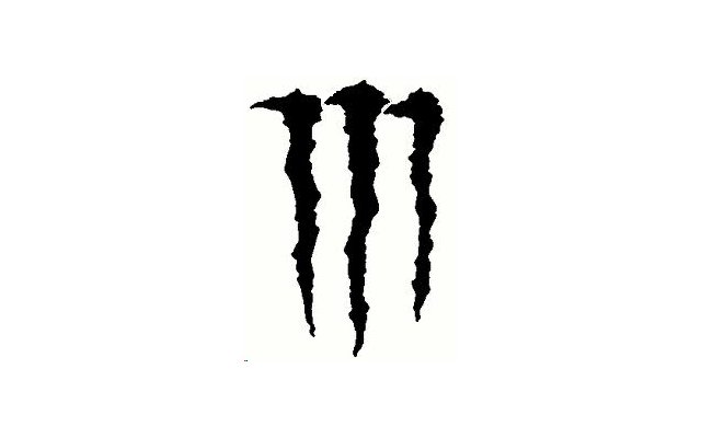

Never have dealt with such confusing software before. I have finally designed and exported a drawing in Inkscape as an .eps file. Have it imported to signcut and, using a pen, can see that it draws what I designed. However, it's saving vinyl and the area cut out surrounding the image is so close to the image itself that it would not work for a stencil because of over spray.
Please...how do I increase the area surrounding the image so I can cut a usable stencil that allows enough area away from the image so it can be used as an airbrush stencil and reduce the possibility of over spray?
Here are the files. First try in uploading them. Hope they get there. Thanks for everyone's help.
