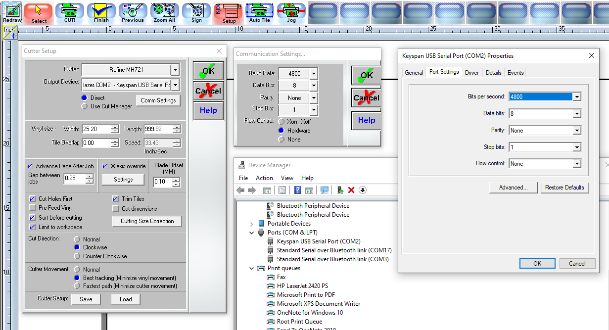

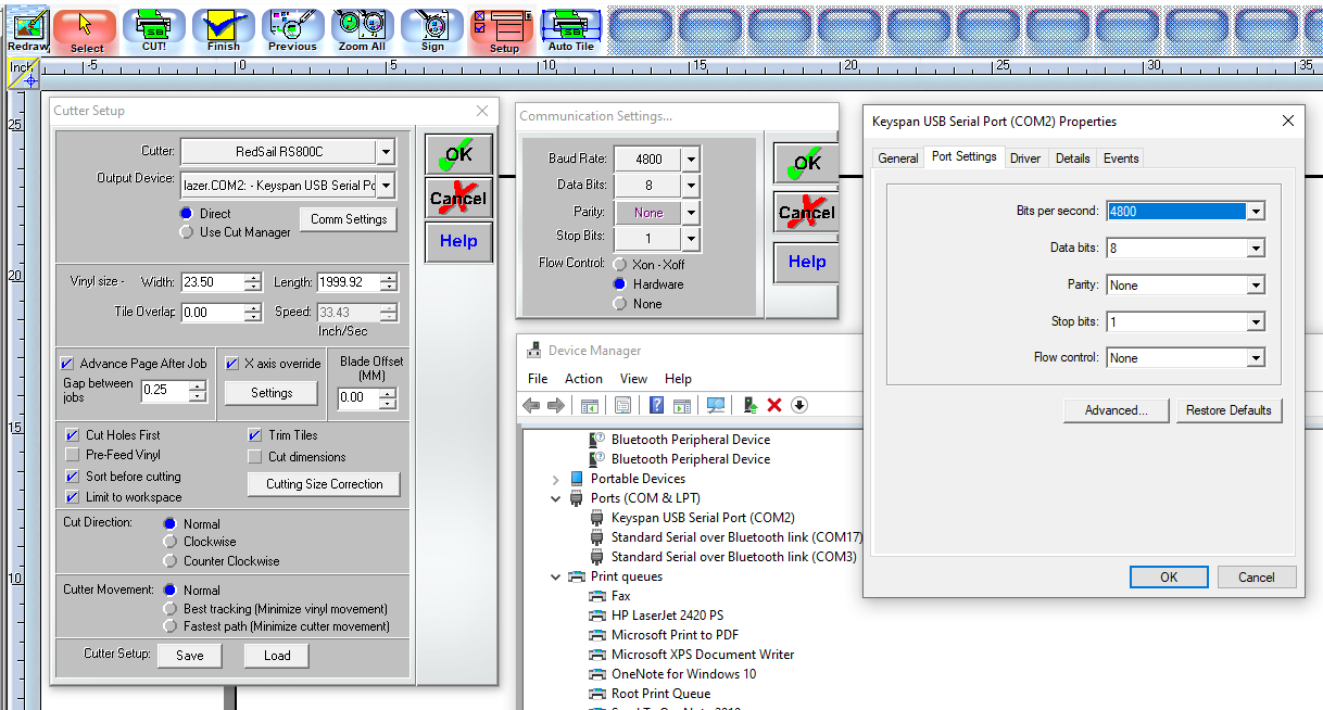

No love from Com2. Here are what the Com settings look like. This will net an the error initializing cutter.FYI, I have two instances of SignBlazer. Release 6.0.21 (Refine) that I have been using and Release 7.0.0 (RedSail) that I found on one of slice&dice's posts. Two completely separate installations. I'm trying to see if one will work. So far, they are both behaving the same way.

I got the latest driver from Tripp Lite. The adapter initially came in as COM18 I adjusted it to COM1. Set the baud in SB to 4800. In my old version of SB, there is an option for Refine MH721, I'm using that. In the newer version, I was able to find RedSail RS800C. Neither are getting through.I also no longer have USCutter listed as a printer.
