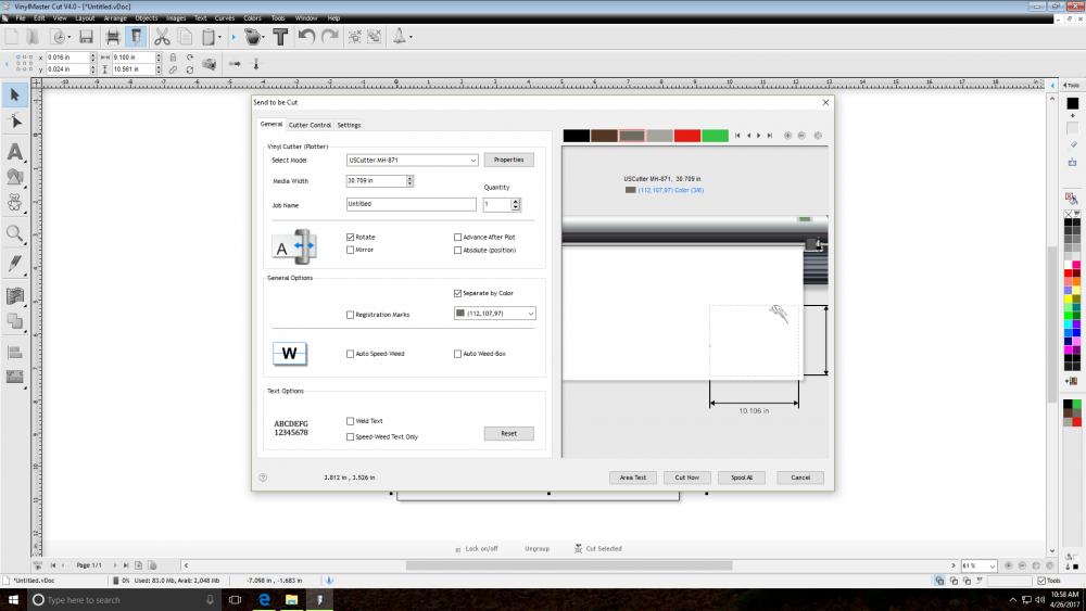

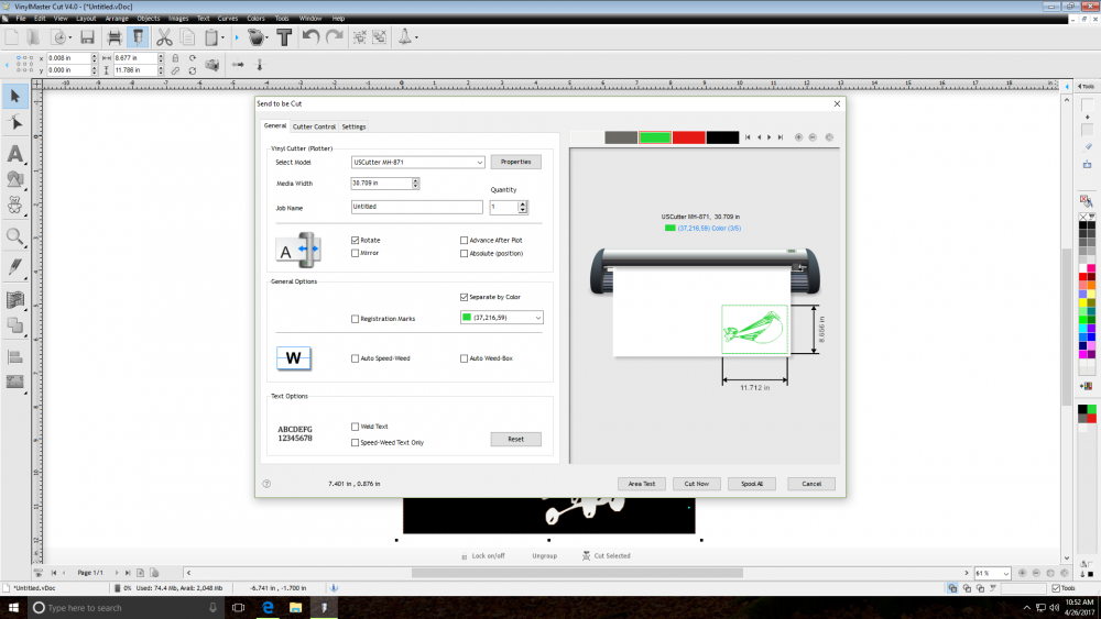

I have imported my image (has multiple colors). First, I imported the eps file. Then sent it to the cutter (see first 4 screenshots). If I go ahead and cut from this, I will end up with 4 layers of vinyl stacked on top of each other. Not good.
Then, when I imported (open from images tab), then vectorize the image, then send to the cutter (see second set of 4 screenshots), only the individual colors are cut and not the entire image of different colors.

1 hour ago, MZ SKEETER said:You have a HELP at the top of the layout screen, with many,many HELP topics.and tutorials...I don't use the software, but found it under color separate...It will cut by color. Do some searching in the HELP topics.. All that info is there to HELP you. And yes you will use extra vinyl layering..You figure it in with the price.
I have read just about the entire HELP section. But with the VM Cut version, those color separate options are not available. In fact, if VM Cut was any more basic, it wouldn't work at all. What are you using MZ SKEETER? I have been able to download a few demo versions of cutting software, minus Flexi (just can't locate a trial or demo version anywhere). I do realize that I need to spend actual money to get what I need to get done, but there are so many options available, it's difficult to decide. Everyone has their preference. This I know. Figuring that out is the hard part.
Thank you. Now I can see how it is supposed to work. Finally, but there still is an issue. I just imported my file, then went directly to cut. When I go and see all of the colors and how it is going to cut, it appears that it will be cutting out the entire image for each color I have, not just the separate layer parts. Is there anyway to not have that happen? Seems like a very big waste of vinyl.

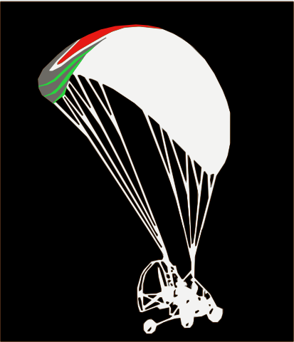

The original image was white to begin with. I just added color to the wing portion. The background is black so I can see what I am doing while designing it. Below is the same image as the one you can see above in my previous post. When I go to vectorize it, it deletes the background automatically, because it will not be cut out on vinyl.
Hope this explains what is happening.
The red X through the black box is getting rid of the black background, so that shouldn't have anything to do with it. The lower portion of the image is white, but I changed it to black so I can see it better. The colors really do not matter of the image as I will be using different color vinyl anyways when cutting. As far as saving the image as an eps, I tried that, but VM doesn't recognize eps files. I have no idea why not, but when I go to import the image, it doesn't see it.

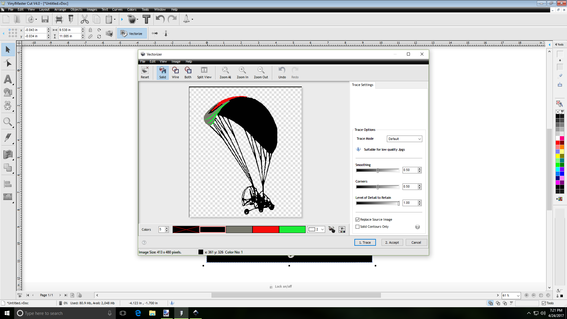

To my knowledge, Vinylmaster Cut is the cutting software. I to have Inkscape, but when I finish designing my image, I save the image as a png file, then open Vinylmaster Cut, then vectorize the image, then cut the image out.
The bottom of the image is black, but it disappears when I press trace. I just don't understand what and why this is happening.
So, still a newbie to this VinylMaster Cut program, but am learning more everyday. I pretty much have the process down and have been cutting vinyl without too much difficulty so far. But today, I have run into something I have only seen once before, but do not know what to do. Below are two screen shots. One after pressing trace, and one after pressing trace, but left clicking on the mouse (while holding the mouse on the image). Why does most of my image (especially the black part) disappear when I press trace, but when I left click on the image, it comes back (as long as I am holding my mouse on the image that is).
