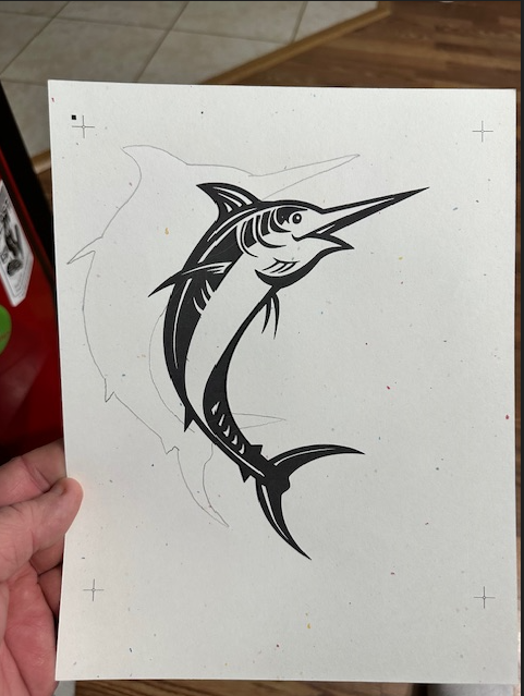

Hello All, Newbie here.... so be gentle
My machine = uscutter MH-MH100  (no A.R.M.S) automatic registration mark sensing / I must do this manually.
  I have an image I sent to "the red apple" for contour outline. Created the outline just fine. Then I sent it to "print" with registration marks. Once load onto the MH100 and located all registration marks I began the cut.
Cut finished but the cutter decided on another location to cut my image on the same substrate and failed to follow the contour lines.... it cut the image but not specifically where I wanted it. ... as you can see I traced the actual cut with a pencil.... Im beginning to question the types of registration marks I used...
Any advice : thanks in advance.

I've never done contour cutting but it appears you need to turn on the option to cut what is on screen. Typically the default setting is to cut the design as close to the origin point as possible which it appears yours has done.
