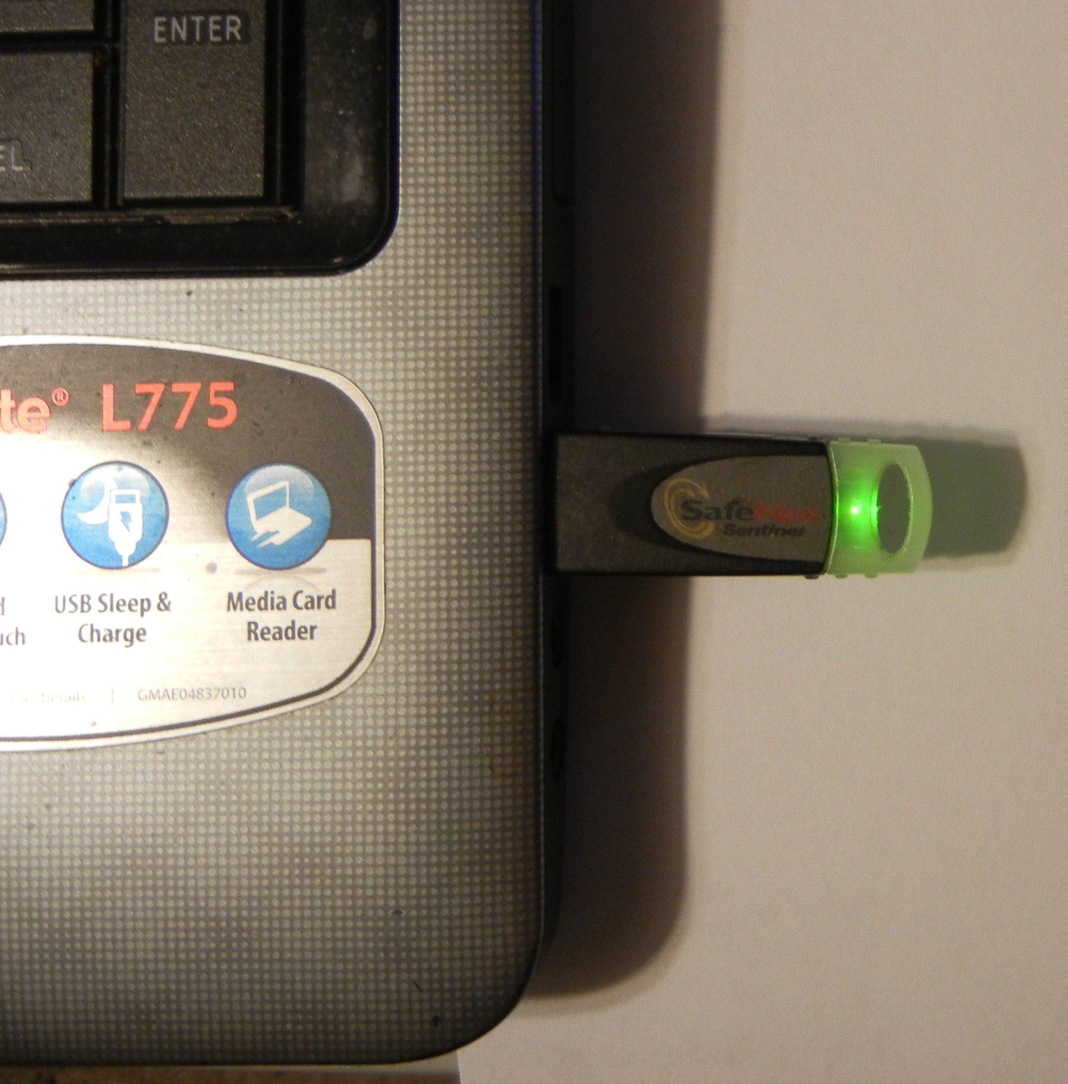

We don't even know what Brand a UScutter Laserpointer 3 is, So how do you know which driver to use in Flexi? Have you even gotten the cutter to cut just regular vector designs yet?  What version of Flexisoftware? Flexi comes in many versions for different versions of Windows. Does your Flexisoftware have a USB dongle, similar as shown?  Is your Flexi software new enough that it has a USCUTTER laserpoint 3 listed as a vinyl cutter choice? Flexi software has a feature in it that is a contour cutting program right in it, and it measures from the blade in the middle of the registration mark. You jog the cutter blade from the middle of each registration mark, (for value cutter) then the software saves those measurements to contour cut. In your case, your cutter ARMS, should read the registration marks. At the top of the layout screen is HELP, all your topics to use Flexisoftware are in those topics.
