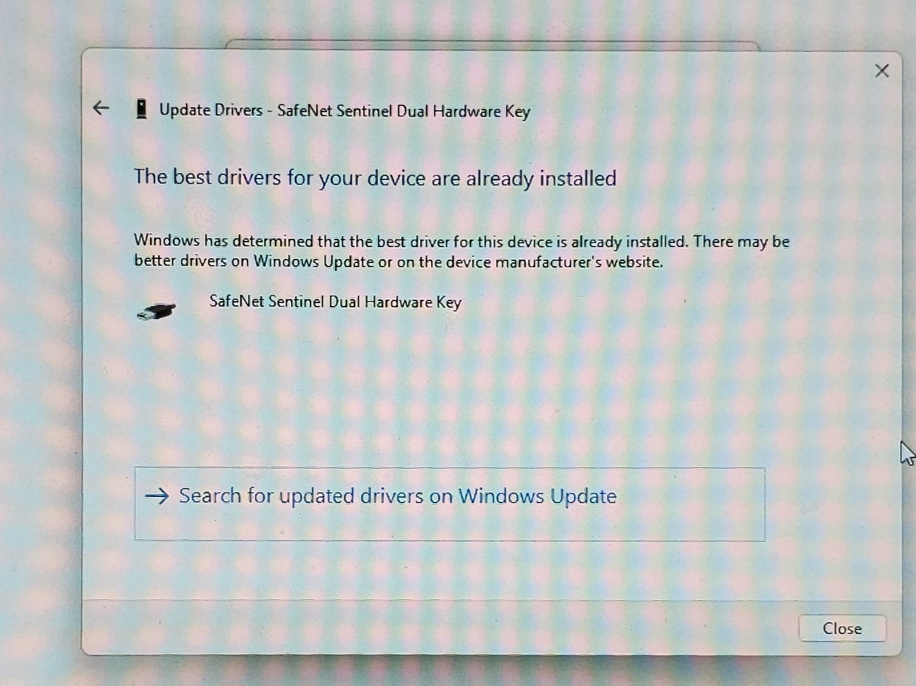

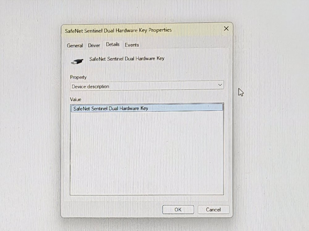

MZ SKEETER 4,727 Posted June 26 down loaded the drivers but still no change You downloaded and then what?. How do you know that the dongle drivers actually installed? Do you see the Safenet in your device manager list under UNIVERSAL SERIAL BUS CONTROLLER? Open that list up and look for it when it is plugged in? I am showing mine. If it is, go into properties of the driver and make sure no question marks, and that it is working. Did the dongle light up? No other program will read FS files, Just Flexi products, just like no other program will read Signblazer files. Share this post Link to post Share on other sites

MZ SKEETER 4,727 Posted June 27 What does the VIEW Details about the installed driver files say? > DRIVER DETAILS. What happens for UPDATE DRIVER? I am referring to the sections on the properties on the right side that you have posted. Have you tried this set up on another computer? Did the dongle ever light up when plugged in? Did you try a different USB port? If not, maybe the dongle is broken. Not much more that I can add. Other than try it on a different computer. Share this post Link to post Share on other sites
termagator 8 Posted June 28 Here's driver details, update driver results. I haven't tried it on another computer cause I'd probably be looking at buying one if this won't work. I d try a different USB port. Hope these images are viewable. Fixing to try another over-install and reboot. Then surrendering. Share this post Link to post Share on other sites
