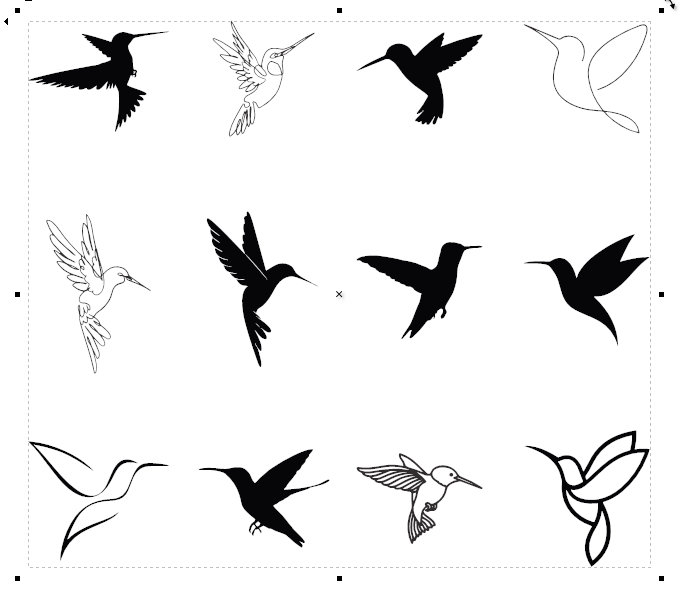

When I purchase a file on Etsy to use in a design, the seller always emails it as one file.  Rather than 10 separate files, it's one. I'll post an example of hummingbirds.  I just need one of the birds, but it is sent as one file with all the birds in it.  How do I delete the other birds so that I can use just one bird for my design?

There are a varieties of ways. The most straight forward way would be to node edit the image and delete all the nodes not on the bird you want.
I don't remember what exactly VinylMaster calls it, but you can apart the design, then delete all the parts you don't want. Depending on the design you may need to merge the remaining parts back together to get the correct look.

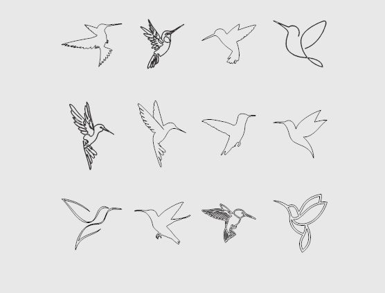

Thank you for getting back to me.  Yes, I have deleted them piece by piece, and I did figure that out by playing around with all the tools/buttons in the software to see what they do. But it takes forever when they're so detailed.  I need to be able to separate the file into individual birds so I can delete all but one.  Each time I purchase something like this, I let the seller know I need separate files due to this.  And they always give me directions on how to do so in Cricut, or they don't even bother to get back to me. I was hoping someone here knew how

Hello, just checking in again to see if there is a way to separate these birds, as I only want to use one of them. The previous poster mentioned "there are a varieties of ways", does anyone know how to delete all of the birds easily?  Thank you!!

Well I find it pretty easy to Grab all of the file> UNGROUP> So they are individual files. Grab the files, either 1 at a time or a group of them and DELETE. what you don't want. .I did it in a Vinyl Master cut Demo. You should be able to.

I broke the birds out to separate files, and zipped them up.
What kind of software are you using for design or cutting?

Ungroup or BreakApart/Split Objects would probably work.
UNGROUP! That's what I was looking for, thank you!
