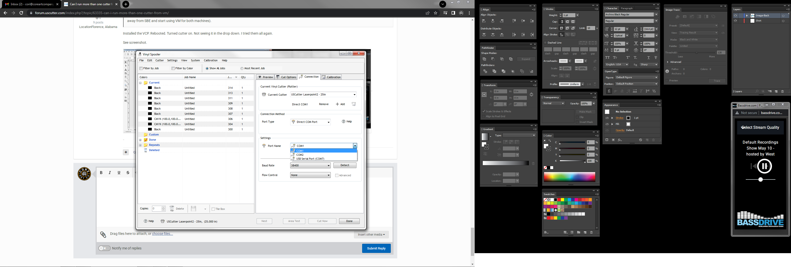

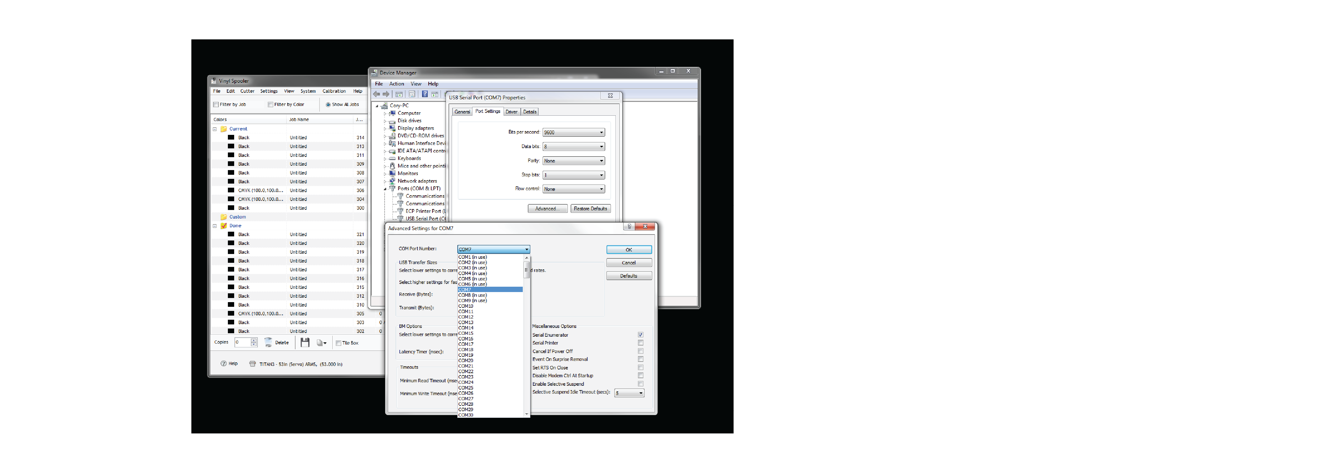

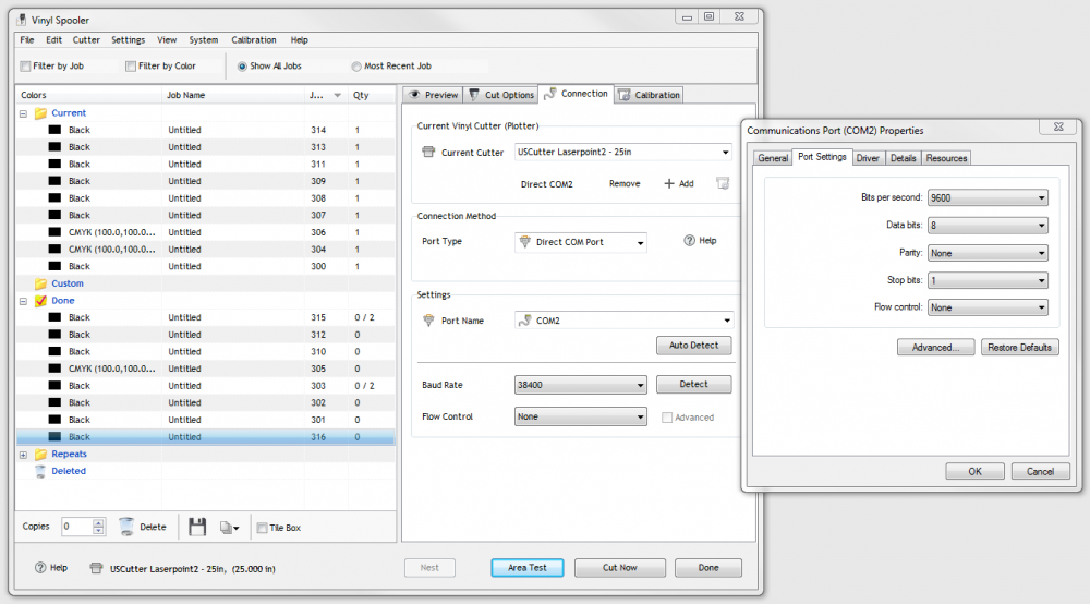

Core Art Company 0 Posted May 11 That is doable. You just change the cutter brand in the vinyl spooler, to which one you want to cut with. Make sure the com ports #s match on computer device manager and VM. The Titan 3 is TRUE USB. Not a com port #. Thank you. I was able to add the LP. I tried both com 1 & 2 with different baud rates, bits per second and flow controls (matching and not matching) Messed with it for a hour to no avail. I'll just send cuts to the Lp with SignBlazer. Its all good. Quote Share this post Link to post Share on other sites
MZ SKEETER 4,726 Posted May 11 Did you first download the FTDI driver for your computer operating system, extract and run it,? Then reboot your computer? It should show that the driver is installed. You must do that. Then Go into your computer device manager and see which com port number that Windows choose. Only numbers between 1-4 will work. Then go to direct com in VINYL SPOOLER and choose the the same com port number. How did you come up with the number 2 for a com port number? You are showing these screen shots of Vinyl Master,, but not showing the photos of your computer device manager, which is where you get the correct com port number from. You have to download and run that driver for value cutters like the LP. Look on the internet for a FTDI driver for your computer system. Your welcome. Quote Share this post Link to post Share on other sites
Core Art Company 0 Posted May 11 Did you first download the FTDI driver for your computer operating system, extract and run it,? Then reboot your computer? It should show that the driver is installed. You must do that. Then Go into your computer device manager and see which com port number that Windows choose. Only numbers between 1-4 will work. Then go to direct com in VINYL SPOOLER and choose the the same com port number. How did you come up with the number 2 for a com port number? You are showing these screen shots of Vinyl Master,, but not showing the photos of your computer device manager, which is where you get the correct com port number from. You have to download and run that driver for value cutters like the LP. Look on the internet for a FTDI driver for your computer system. Your welcome. I did not download any drivers. I thought I already had the driver since I've been running the LP off this computer. That right dialog is from device manager port settings. Anyways, I'm super confused and will probably just continue with SB for the LP, until I have more time to mess with it. Not a big deal. Oh and I chose Com2 since that's what I used to run when I used the communications cable. Ive been running the Lp with a USB through Com7. Thank you for your help. Quote Share this post Link to post Share on other sites

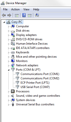

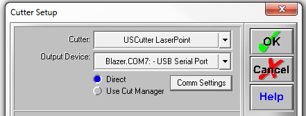

slice&dice 2,467 Posted May 12 CoreArt, whazzup? First of all, as far as we know, SignBlazer supports Com ports 1-4 only so how are you successfully using COM7? Interesting to see that configuration in SBE (screenshot). Check this little item out -- it creates a Virtual Com Port, (STM32) and that should allow VM to just see the LP using that. https://quadmeup.com/stm32-virtualcomport-driver-for-windows Quote Share this post Link to post Share on other sites
Core Art Company 0 Posted May 12 CoreArt, whazzup? First of all, as far as we know, SignBlazer supports Com ports 1-4 only so how are you successfully using COM7? Interesting to see that configuration in SBE (screenshot). Check this little item out -- it creates a Virtual Com Port, (STM32) and that should allow VM to just see the LP using that. https://quadmeup.com/stm32-virtualcomport-driver-for-windows Wazzup! See screenshot. Thats what Im using in SB. Its just a usb cable. Quote Share this post Link to post Share on other sites

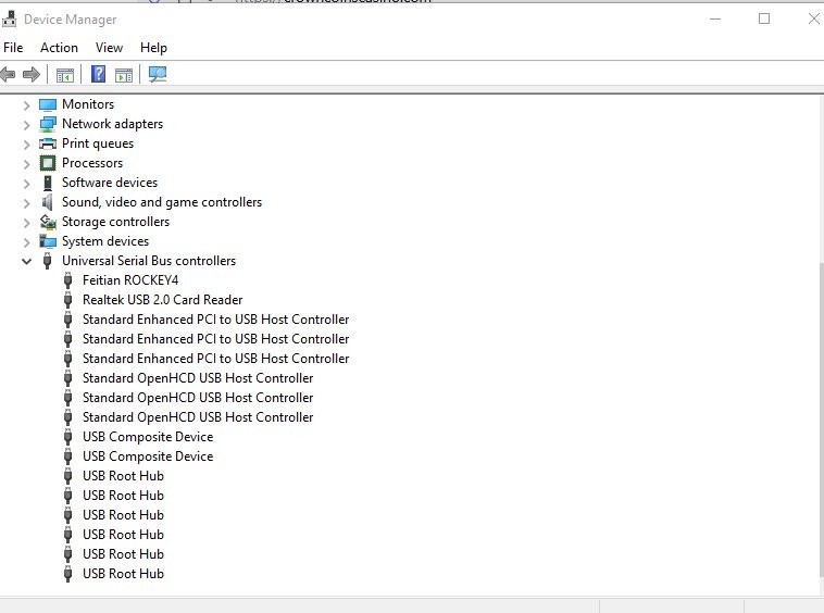

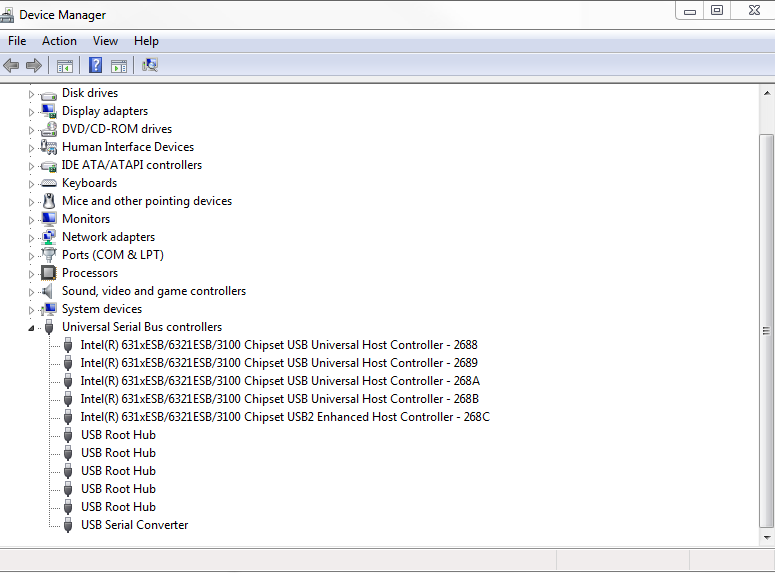

MZ SKEETER 4,726 Posted May 12 In your control panel is your device manager, We are asking to see this. Yours should be similar. Open the Universal Serial Bus Controller. Quote Share this post Link to post Share on other sites
MZ SKEETER 4,726 Posted May 12 Can you show your device manager with your cutter turned on and cutter hooked up in Signblazer? Quote Share this post Link to post Share on other sites
Core Art Company 0 Posted May 12 Can you show your device manager with your cutter turned on and cutter hooked up in Signblazer? Quote Share this post Link to post Share on other sites
slice&dice 2,467 Posted May 13 The VCP connection should be listed under PORTS, not USB. You asked to get this LP working on VinylMaster, I believe that my method will work. (The fact that SignBlazer manages to function with the assigned USB Port7 is indeed interesting, but irrelevant to the subject of this thread, which is an attempt to migrate away from SBE and start using VM for both machines). Quote Share this post Link to post Share on other sites
MZ SKEETER 4,726 Posted May 13 I was going to mention opening the PORTS (COM) NEXT. Quote Share this post Link to post Share on other sites
Core Art Company 0 Posted May 13 The VCP connection should be listed under PORTS, not USB. You asked to get this LP working on VinylMaster, I believe that my method will work. (The fact that SignBlazer manages to function with the assigned USB Port7 is indeed interesting, but irrelevant to the subject of this thread, which is an attempt to migrate away from SBE and start using VM for both machines). Installed the VCP. Rebooted. Turned cutter on. Not seeing it in the drop down. I tried them all again. See screenshot. Quote Share this post Link to post Share on other sites
slice&dice 2,467 Posted May 13 We're back to the PORTS again, in the Device Manager. There should be a VCP STM32 listed (assuming you have Win 7 or 8 or below -- Starting from Windows® 10, the STM32 driver is not applicable for use). Quote Share this post Link to post Share on other sites
Core Art Company 0 Posted May 14 We're back to the PORTS again, in the Device Manager. There should be a VCP STM32 listed (assuming you have Win 7 or 8 or below -- Starting from Windows® 10, the STM32 driver is not applicable for use). Nope Quote Share this post Link to post Share on other sites
darcshadow 1,641 Posted May 14 The USB Serial Port is most likely your cutter. Right click on that and change the port number to 3 or 4. Then in Vinyl Master select the comm number you just set in the Device Manager. You have two comm ports in Device manager, do you actually have two DB9 ports on your computer? If you do, I'd recommend just getting a serial cable and go that route, no need for drivers. Quote Share this post Link to post Share on other sites
Core Art Company 0 Posted May 14 They are all in use. Quote Share this post Link to post Share on other sites
