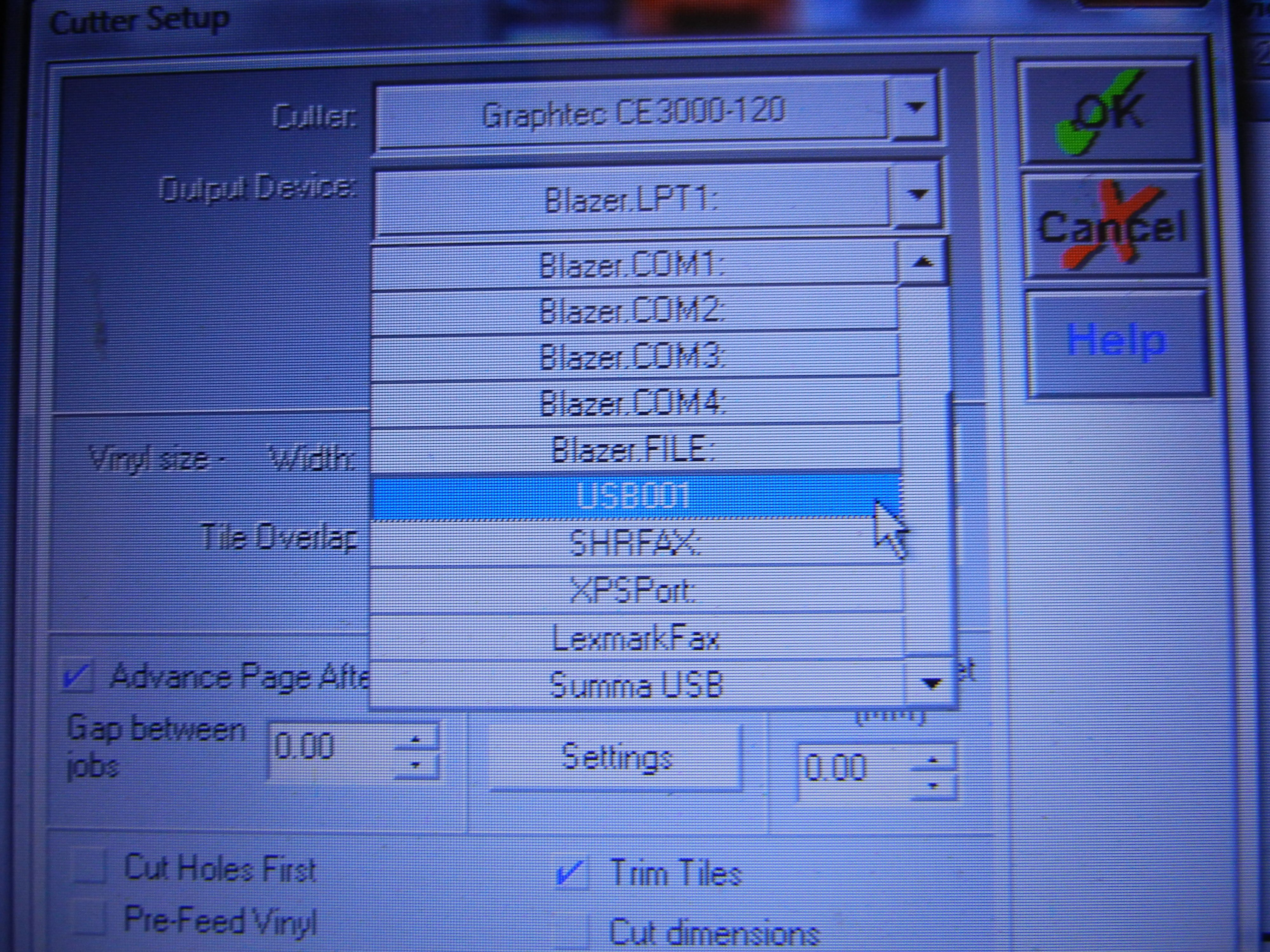

paz21paz 7 Posted March 18 It shows it's on port 4. I'm looking to get usb001 or usb002 one like that to show up in the list of options in setup. That is the way I've had it connected on other computers. Share this post Link to post Share on other sites

MZ SKEETER 4,720 Posted March 19 We have seen this before on here, when people were using Windows 7 and lower. and moving, up to Signblazer, on Windows 10, 11. This OP has a Graphtec, with TRUE USB. (Reading previous posts)The USB001, USB002 does NOT show up in Signblazer set up now.. Don't need another COM. This COM driver will not work for that. They have already said it a couple times. Needs USB001 or USB002 as shown. In higher Windows, Signblazer they are losing the USB001 and USB002. It is not on the list anymore. This photo is on Windows 7. I would recommend connecting with a Tripp-Lite Keyspan Adapter/null modem cable and be done with it. The serial port on a Graphtec is 32 pins, Get an adapter. for the cutter. Tripp-lite has it's own driver. Share this post Link to post Share on other sites
