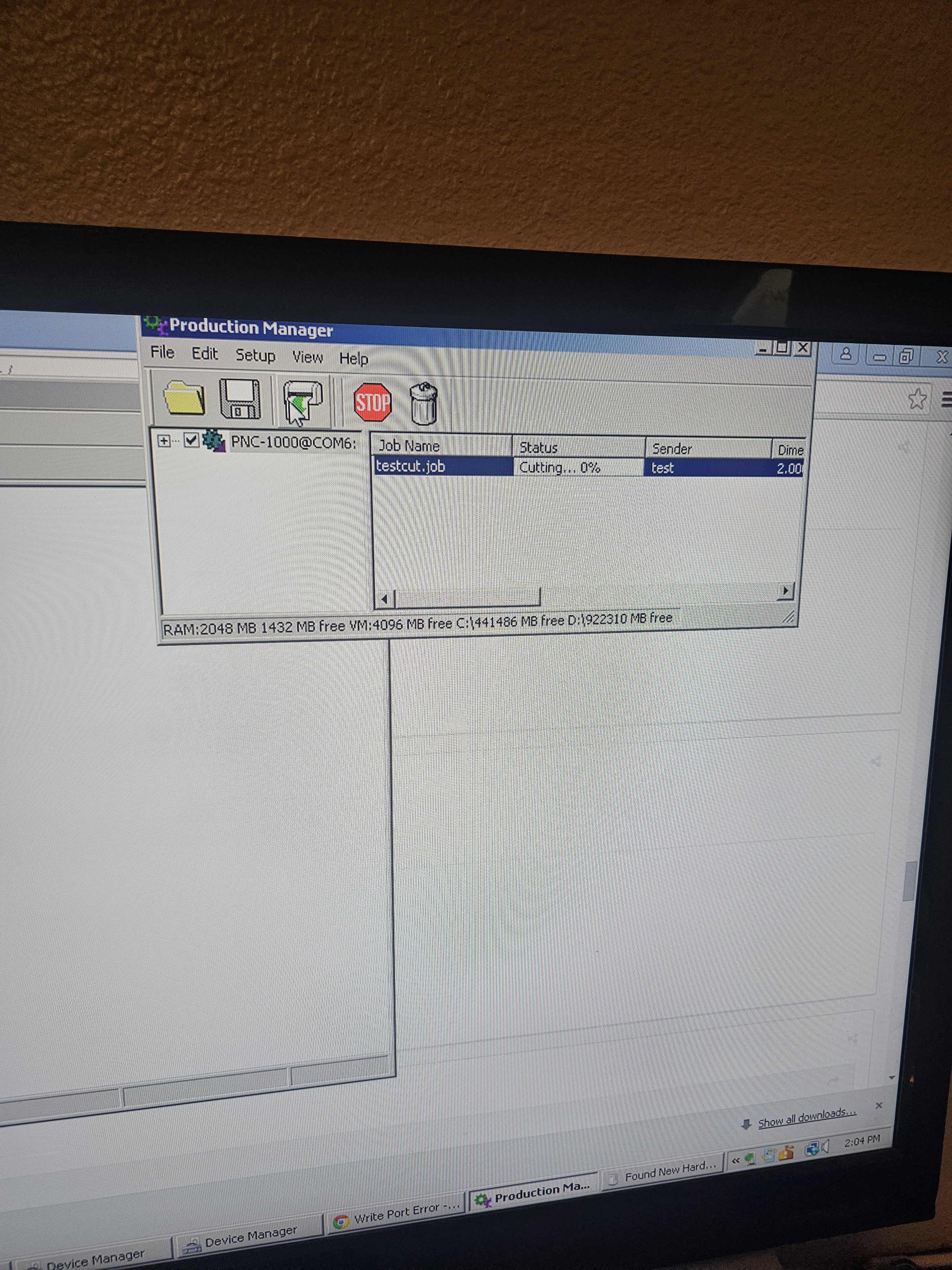

claimer14 0 Posted October 7 Hello, I have a mh1351, flexi 7.5 and 7.6, using a USB adapter. First picture is when trying to cut. Any suggestion what to check for. Thank you Share this post Link to post Share on other sites

claimer14 0 Posted October 8 Alright I will change it to lower port, I switched to different port seeing if that would work. It was on port 4 before changing. Second picture is when I send it to the cutter then first picture comes after that giving write port error. It just stays at 0%, I will try using serial to serial cable. Thank you, will update once try them Share this post Link to post Share on other sites
