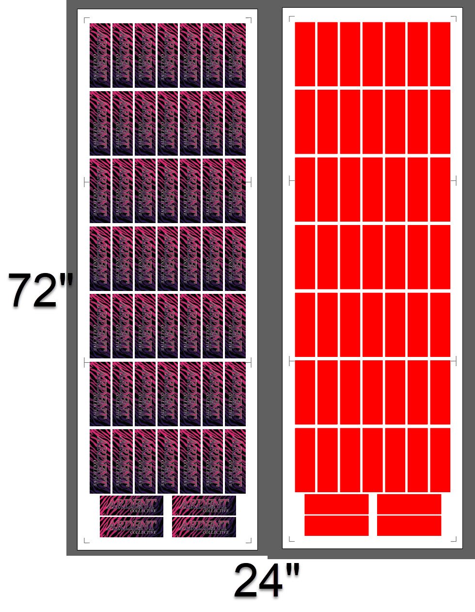

levy4u 19 Posted July 24, 2021 7 hours ago, slice&dice said: Was that the 'Hoff?!! Sure is! I have a lot of car club customers that make some unique "slap" stickers. 11 hours ago, MZ SKEETER said: Didn't you get the license code for Graphtec Pro Studio, so you could activate it? It is FlexisignPro without the RIP. Over a $1000 software. Better than any other Graphtec software. I just downloaded it but don't see what it does any better than Adobe Illustrator. I only use CM4 to send the job to the cutter, designing and all that is done in non Graphtec software. The Graphtec Pro Studio Plus looks nice with the nesting, cut paths, etc but it's an extra $500... and my issue is with the actual cutter not operating correctly while cutting in one direction. No response from Graphtec support yet. This is the print and cut file I'm using if it helps. Share this post Link to post Share on other sites
