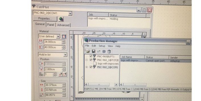

sophie reynolds 0 Posted October 10, 2020 I don' t think its the software or the cutter that are the problem. I'm sure its the laptop. I dropped my old one so had to get a replacement one that ran xp. Share this post Link to post Share on other sites
MZ SKEETER 4,727 Posted October 10, 2020 I have been running XP since 2006, never a problem. Several different laptops. Windows will shut down pirated software. Try Signblazer Share this post Link to post Share on other sites

MZ SKEETER 4,727 Posted June 10 I am going to update this, I was rereading this thread, because I saw someone reading it recently. I had told this OP several times, in Flexi software, that her setting in Flexi was not correct. Her setting was set to HOLD IN LIST. Instead of SEND NOW. That is a dropdown box. When it is set to HOLD IN LIST, the cutting software will never send the file. The setting has to be on SEND NOW. Her very last photo STILL shows HOLD IN LIST. In my opinion. That was the problem after the drivers situation was sorted. Left side of photo, below the 1st sizes. Share this post Link to post Share on other sites
