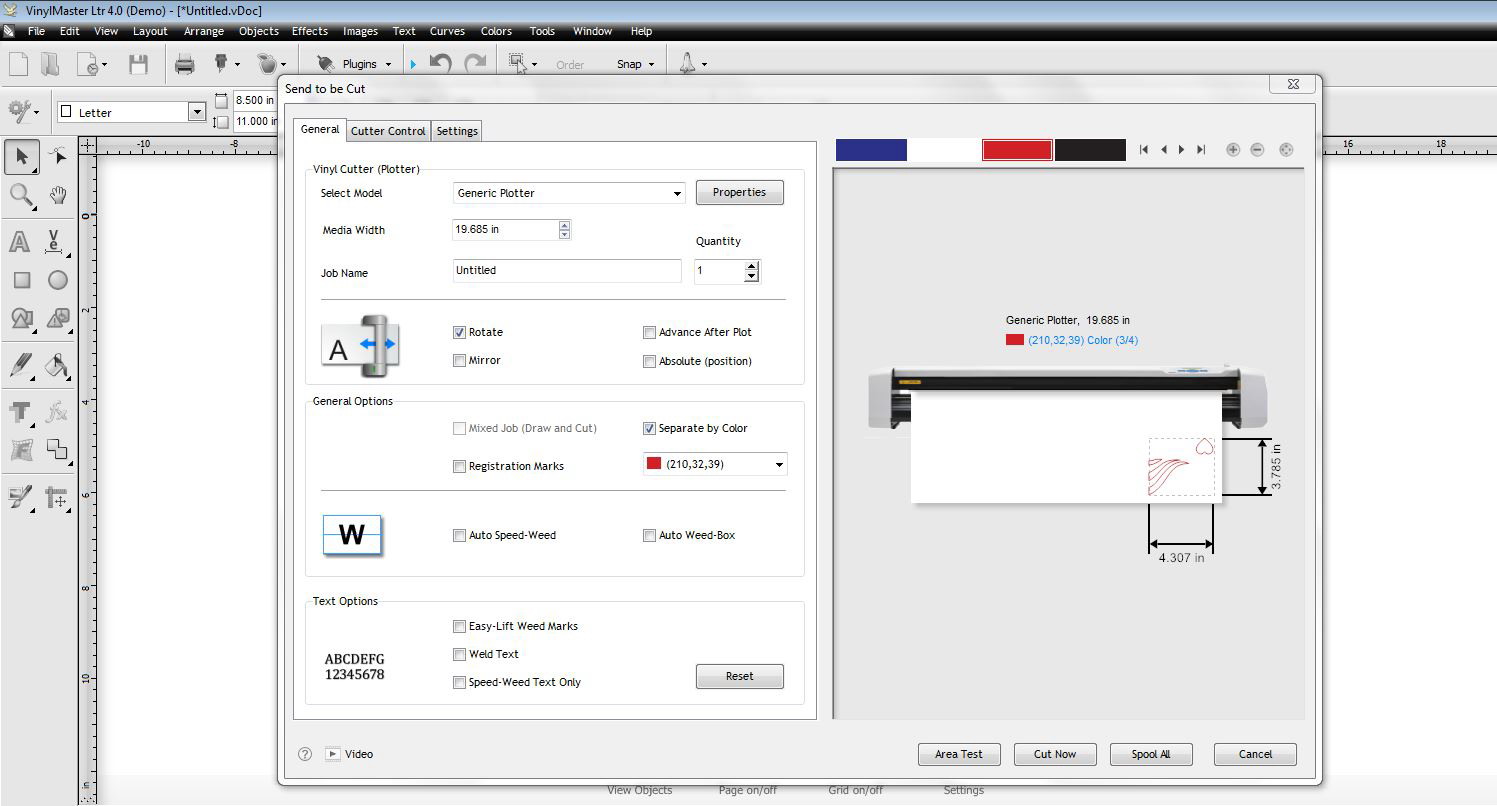

Blackjack2359 0 Posted April 26, 2017 It's me again. Don't mean to be a pain in the rear. I really want to learn how to use this software effectively and learn what it can and can not do. I have imported my image (has multiple colors). First, I imported the eps file. Then sent it to the cutter (see first 4 screenshots). If I go ahead and cut from this, I will end up with 4 layers of vinyl stacked on top of each other. Not good. Then, when I imported (open from images tab), then vectorize the image, then send to the cutter (see second set of 4 screenshots), only the individual colors are cut and not the entire image of different colors. I sure hope I am explaining myself well enough. I would love to have been about to just use a eps file, but not at the expense of stacking all my layers of vinyl. Oh, but the way. I'm using VM Cut (not pro, LTR, or DSR). Quote Share this post Link to post Share on other sites
MZ SKEETER 4,728 Posted April 26, 2017 You have never posted your cut file from Inkscape. How do you know it is correct? I just imported a colored .eps file from a purchased disc. I am using VM Letter Demo and it looks just like yours. I did not revector the file in Vinyl Master, and it separated the colors just fine for each part of the design. So it does not have be vectored from Vinyl Master to work. Post your vectored file. Quote Share this post Link to post Share on other sites
MZ SKEETER 4,728 Posted April 26, 2017 Image was purchased, on a disc....all I did was import it into Vinyl Master....Worked fine. Every color was separated for each part. Quote Share this post Link to post Share on other sites
VinylMaster 148 Posted April 26, 2017 6 hours ago, Blackjack2359 said: I have imported my image (has multiple colors). First, I imported the eps file. Then sent it to the cutter (see first 4 screenshots). If I go ahead and cut from this, I will end up with 4 layers of vinyl stacked on top of each other. Not good. This looks like the same artwork (graphic) but in different colors, and not separate parts of some multi-color artwork. Also, when you refer to an image this means: bitmap, picture, scan or photograph. So please refer to vectors as either curves, paths or vector artwork so we know which you mean 2 Quote Share this post Link to post Share on other sites
