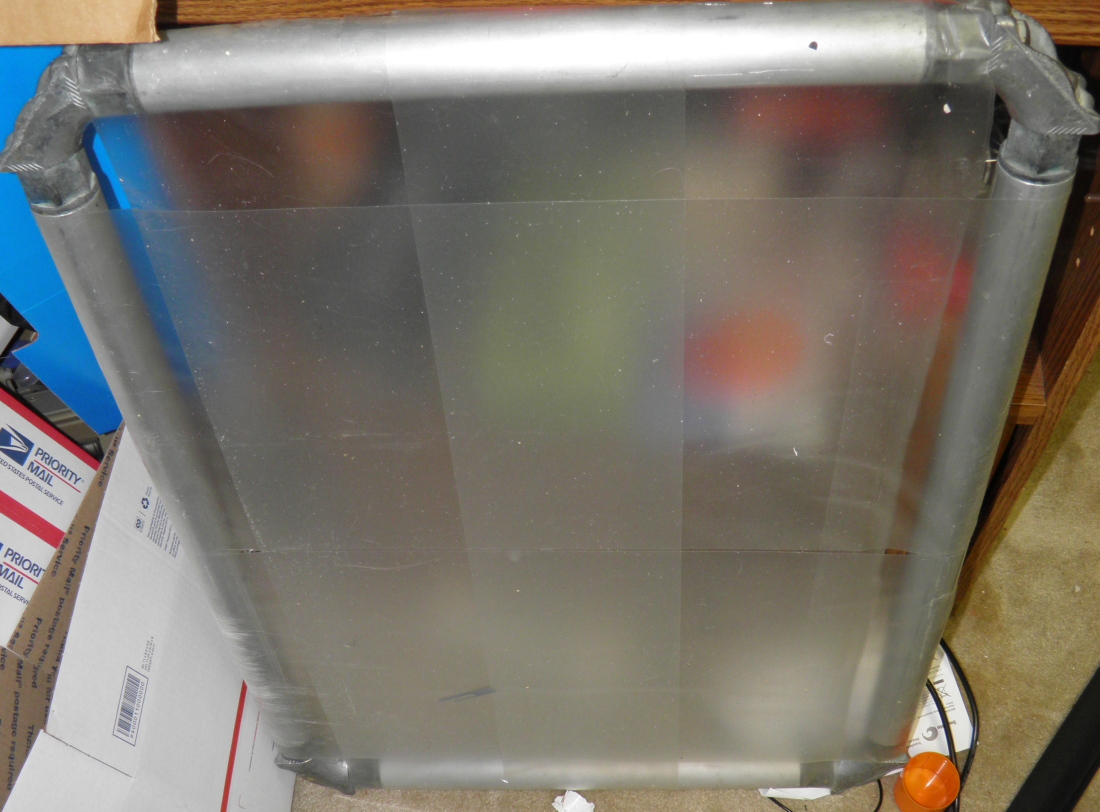

when I have a bunch to do I put new app tape on a newman roller frame (for screen printing) and use that - easy to line up and get lots our of one set of app tape - actually first couple are a little too sticky but works great
