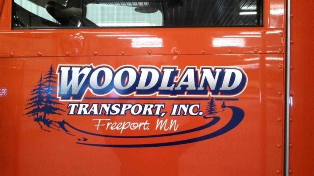

Justin737 1 Posted October 3, 2014 Hi, I have been trying to remake this image and cant figure out how to remake the fill in the word WOODLAND. Its like a speckled fade? Anyone know how to do this? Thanks in advance! Share this post Link to post Share on other sites

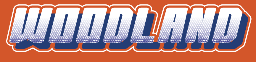

OWJones 1,981 Posted October 3, 2014 I did this as I described it - I didn't take the time to find a better speckle pattern to use as a fill, but this was all done in CorelDraw X6. Share this post Link to post Share on other sites
OWJones 1,981 Posted October 3, 2014 That "give it a speckled fill" can't be done as posted without using masks.You have to apply the specks then hide them, in graduation, with a layer or clipping mask. I duplicated the white WOODLAND text on top of itself. I then used the Interactive Fill tool to apply a 2-color pattern of dots, which I colored dark blue on a white background, to the top layer of white text. I then applied the Transparency tool and selected Linear and drug the control boxes from the bottom up and adjusted the top and mid point to get the look I was going for. All done in vectors with vector tools, no masks required. It would probably be loads easier to do it in Photoshop (I wouldn't know, I suck with raster based graphics tools), but since this was the CorelDraw forum, I showed how I would do it in CorelDraw. Share this post Link to post Share on other sites

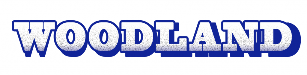

Justin737 1 Posted October 3, 2014 Think I figured it out! Probably play with it some more to get it right. Thanks for the help everyone! 1 Share this post Link to post Share on other sites
skarekrow 1,842 Posted October 3, 2014 What program did you do that in, Justin? Share this post Link to post Share on other sites
Justin737 1 Posted October 3, 2014 Corel Photopaint. Did a noise effect on it then adjusted the color with the color management tool to get it close from there. Share this post Link to post Share on other sites
